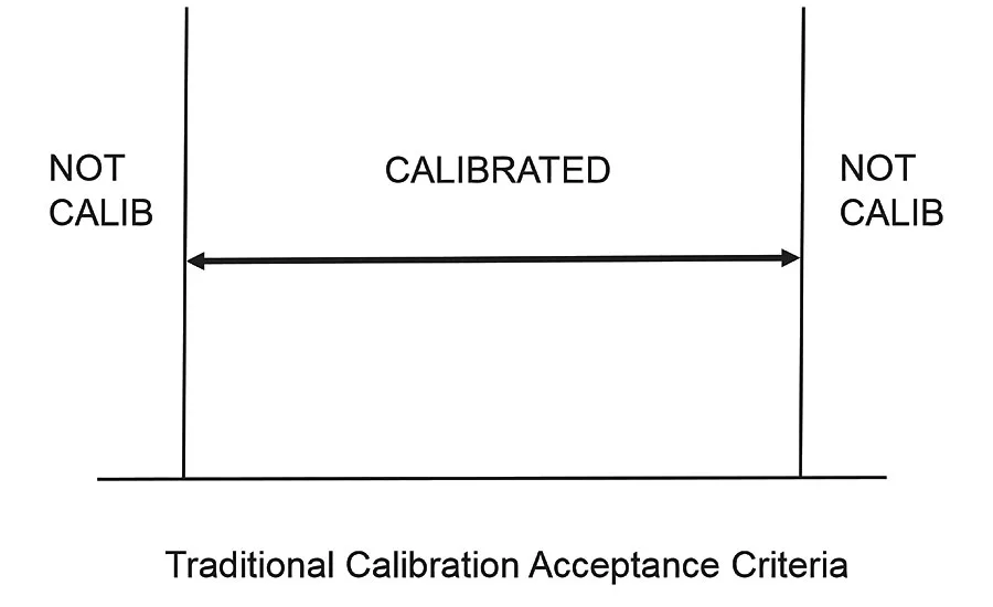

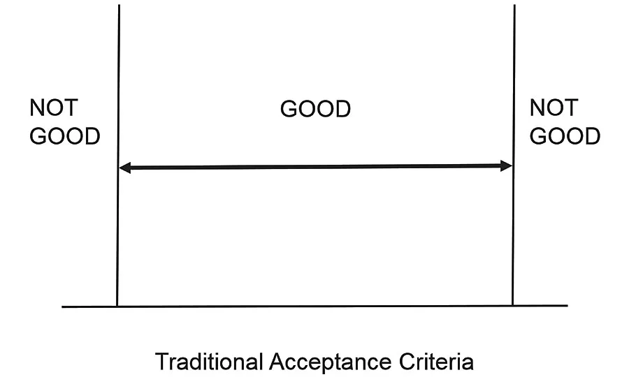

The traditional approach to the acceptance of a measurement has been on a go/no-go, good/not good basis (Figure 1a). If the measurement is within specification limits, it passes. If not, it fails. The traditional viewpoint on whether an instrument is correctly calibrated or not is based on the same go/no-go criteria. As long as the instrument is within the standard range, it is considered calibrated. (Figure 1b).
 A critical, yet often overlooked, part of the journey toward reducing variation and continuously improving is developing confidence in the system that is used to measure the process. Most of the improvement efforts in organizations are spent on reducing variation among products. Little if any attention is paid to the variation introduced into the overall picture by the measurement system itself.

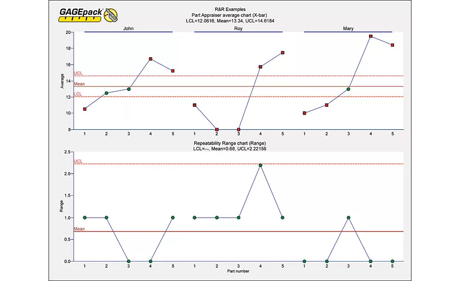

Another way to visualize the measurements is with the use of an X-bar and Range chart. The X-bar chart shows the instrument’s power of discrimination, or the ability of the instrument to tell one piece from another. In this type of study, we want as many points out of control as possible. The X-bar will show the average values of the measurements for many parts in a study. The Range chart shows the error of measurement, since the R values are the differences between successive measurements of the same product. An unstable R-chart is an indication that the instrument operator may be having trouble taking consistent measurements. In general, the average range should be as small as possible, with few or no indications of instability.
One manufacturing site experienced an unusual number of out-of-control points on the Range chart for one of their gage R&R studies. This led management to believe the operators were struggling to get consistent measurement replications. After some root cause analysis, a quality technician discovered that the gage hadn’t been calibrated for several months before the R&R study, and the device was out of tolerance.  After the gage was calibrated, the study was repeated and the special cause variation in the Range chart was eliminated.

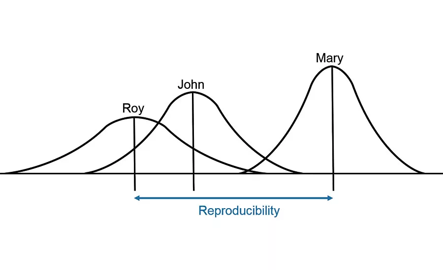

A focus on reproducibility compares operator variation. The reproducibility is the variation between the averages of different operators, when using the same equipment, same sample or part, and the same characteristic. It indicates the operator variation in the measurement system and is commonly referred to as appraiser variation (AV).² In the previous example, the measurement error consisted of the error of the equipment and one operator. Figure 3 shows an X-bar and Range chart for a study where three operators (John, Roy, and Mary) took two readings on five different parts with the same instrument.
The X-bar chart shows that all three appraisers have fairly decent agreement, but Roy’s measurements of part two and three are significantly different from the other two operators’ measurements. In addition, the Range chart highlights the variation for operator Roy, which is greater than operators John and Mary.
An easier way to visualize Roy’s noticeable variation between measurements is with the Figure 4 distribution curves. We hope to see a tall and narrow histogram, which demonstrates consistent measurements from one replication to another. Mary’s measurements are the most consistent of the three operators, where Roy’s distribution is wide and flat. Upon further investigation, the company discovered that Roy was a new hire who had not received proper training on the measurement procedure. After he successfully completed the training program, the study was repeated, and his measurements were much more consistent, resulting in a dramatic improvement in the measurement system as a whole.
