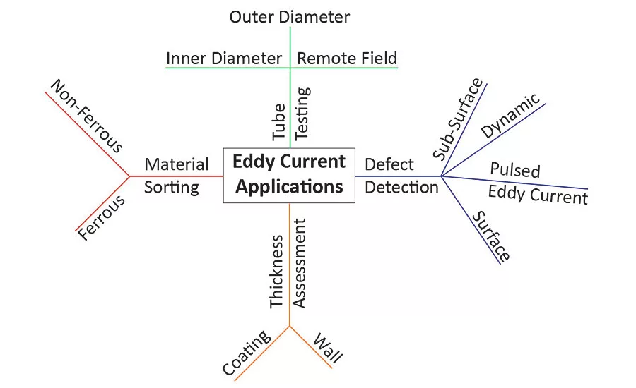

Eddy current testing can be used for a wide range of applications. It is often applied for surface crack detection and material sorting. Material sorting is used to ensure that the proper materials are in use and to verify component materials or assembly features (such as the orientation or position of a subcomponent in an assembly). Figure 2 shows the range of application types of eddy current inspection.

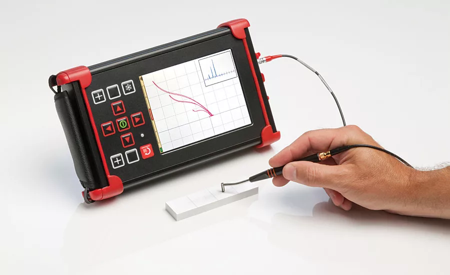

It’s usually carried out with pencil probes or ‘pancake’ type probes on ferrous or non-ferrous metals. Frequencies from 100 kHz to a few MHz are commonly used. Depending on surface condition it is normally possible to find cracks 0.1 mm or less in depth (as shown in figure 3).

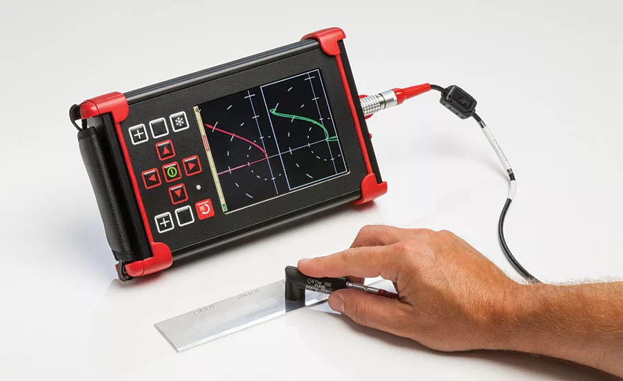

More complex are dual or multiple frequency inspections (figure 4). These are commonly used for tubing inspection, in particular for suppression of unwanted responses due to tube support plates.

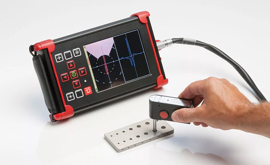

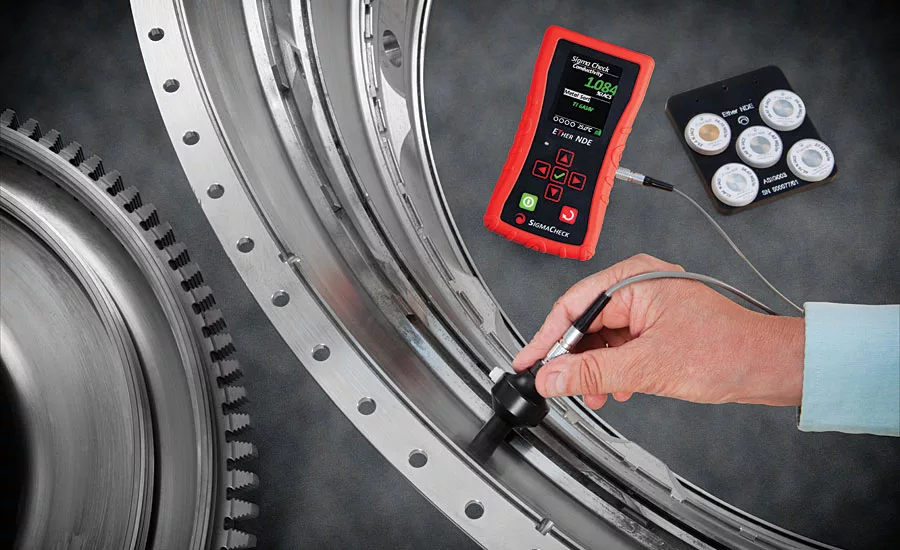

For nonferrous materials such as aluminum and copper, eddy current electrical conductivity measurements are often used to verify material characteristics.
For raw and processed materials conductivity measurement can determine the purity of the metal.
Heat treatment of aluminum affects the metallurgical structure of the material, which in turn affects the electrical conductivity. Published charts list expected electrical conductivity values for the various heat-treat conditions of aluminum alloys.

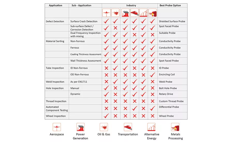

Eddy current inspection can be used across a wide range of industries for a large number of applications. Figure 6 demonstrates the industries that this technique can be used in, the application types and what type of probe you would use to complete your eddy current inspection. This table proves that although eddy current inspection can seem complex, it is extremely versatile.
