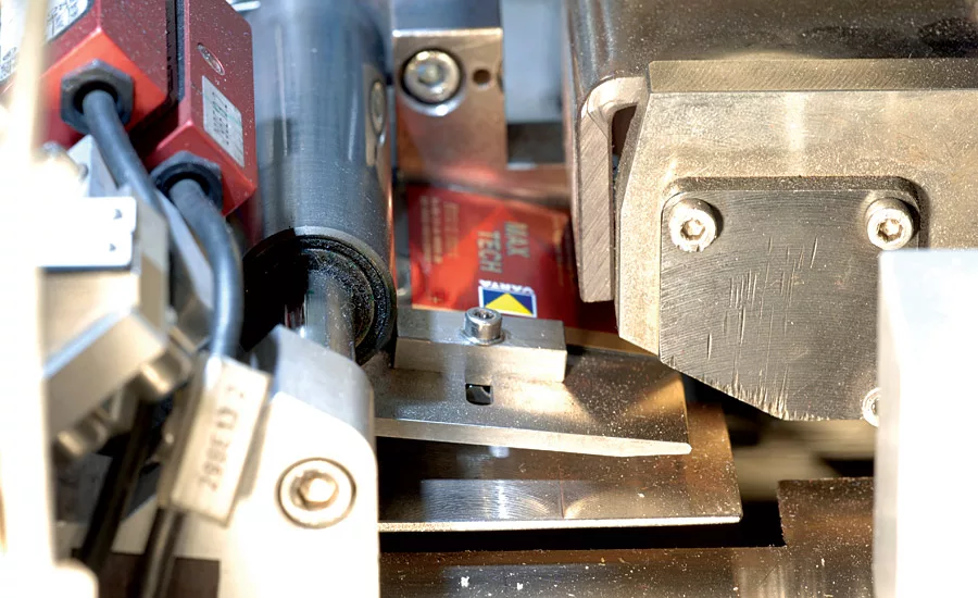

The labelling machine runs at a clock rate of up to 1,000 units per minute. The error analysis of this machine by means of high-speed recordings with the camera would not have been possible without the simultaneously high image resolution. Source: MIKROTRON

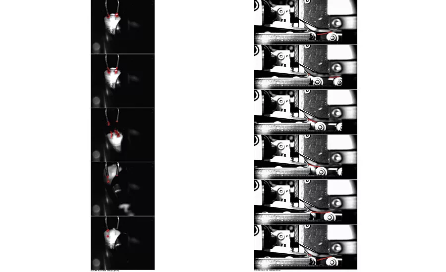

LEFT: A missing electrolyte drop changes the battery characteristics, contaminating the production facility and increasing maintenance costs. The relevant process parameters could quickly be optimized with the help of slow-motion studies. In the picture, the drops are colored red. Source: MIKROTRON
RIGHT: The camera had to be fitted to the side. From this perspective, the labels were only visible as a thin line. In the high-speed recording, they are marked with a red outline. Source: MIKROTRON

When problems occur on a production line, the cause can often be difficult or impossible to identify. Mechanical errors can happen so quickly that it’s impossible for staff to intervene before there are interruptions, shutdowns, or wastage. When a line is producing at a cycle rate of, say, 100 pieces per minute, the human eye and brain simply can’t see or compute what’s going wrong.
As a consequence, at one time or another most plant operators will find themselves faced with the same puzzling questions: are production line glitches a consequence of tools or equipment wearing out, or products or operators on the line changing, or machine operating parameters needing adjustment, or productivity targets simply being unrealistic? The answer can often be found by using specialized high-speed recording cameras.
Unlike image processing cameras, which are used by plants as quality assurance to prevent the delivery of faulty parts, the job of high-speed cameras is to make production processes visible, enabling plant operators to document specific phases of the process. Detailed frame-by-frame analysis of photographic images can identify the causes of problems, leading quickly to solutions that bring the plant up to planned productivity levels. In many cases, a detailed visual investigation highlights opportunities for unforeseen process efficiency improvements with the result of boosting productivity even further.

Varta Consumer Batteries, one of the largest battery producers in the world, is another company benefitting from high-speed cameras. Varta’s newest-generation batteries perform significantly better than rivals’ as a result of a specially formulated electrolyte, which is injected into the battery casing. The filling process requires precise dosing when only a few hundredths of a second are available, but at the company’s plant in Dischingen, near Munich in Germany, there were often problems with a missing electrolyte drop changing the battery characteristics and contaminating the production line. This was causing product rejections because of unacceptable fluctuations in the individual batteries’ performance, forcing expensive maintenance downtime on the production line.
By conducting slow-motion studies with high-speed recording cameras, it became possible to see how process parameters should be adjusted so that the high quality requirements could be met while maintaining a very short cycle time. Project engineer Josef Graule explains: “After making only a few high-speed recordings, we were able to select the filling jets in such a way that the filling process ran without any more troublesome splashes. Next, the camera provided us with information we could use to constantly reduce bottlenecks in the production flow.” Within the first year, investigations of more than 20 points in the production process led to a substantial number of optimizations.
