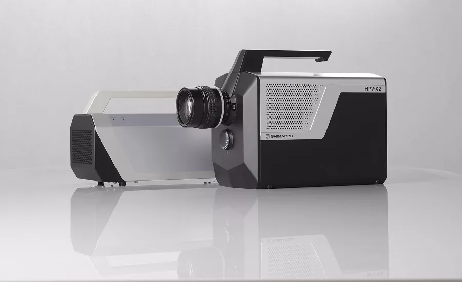

Shimadzu released its first high-speed video camera in 2005. The newest model, the Shimadzu HPV-X2, is capable of recording at 10 million frames per second.
Advanced image sensors using CMOS technology have contributed greatly to the development of high-speed video cameras, according to Shimadzu. With CMOS technology, pixels and memory are spatially separated to achieve high-image quality with no signal leaks.
Shimadzu utilizes a burst image sensor (developed in collaboration with Professor Shigetoshi Sugawa of Tohoku University) which has the same number of built-in memories as number of frames recorded. Furthermore, pixel and memories are connected by wire in a one-to-one manner in order to completely parallel transfer the video signal from the pixels to the memories. This makes it possible to realize ultra-high-speed recording at 10 million frames per second. In addition, since it’s not limited to the number of signal output taps as with conventional serial transfer system, high-resolution recording at ultra high speed is available.
