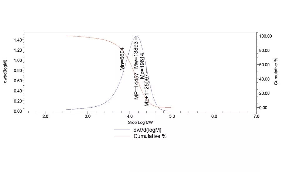

The third important component of polymer chemical structure is the molecular mass distribution. This measurement provides an understanding of the average polymer chain length and the range of chain lengths present in the material. Chain length contributes directly to a variety of polymer properties, including toughness, durability, and ability to flow. SEC was used to measure the molecular mass distributions of these polymers. SEC data are reported as the moments of the distribution of chain lengths observed, usually denoted as MN, MW, and MZ. The range of chain lengths observed, also termed the polydispersity index (PDI = MW/MN), is another important parameter for characterizing the molecular weight distribution. For these polymers, SEC analysis shows polymers with the following characteristics:
  • MN ranging from 5,000 D to 27,000 D
  • MW ranging from 11,000 D to 174,000 D
  • MZ ranging from 16,000 D to 320,000 D
  • PDI ranging from 1.7 to 9.6
Figure 1 shows a typical SEC chromatogram for one of these polymer samples.

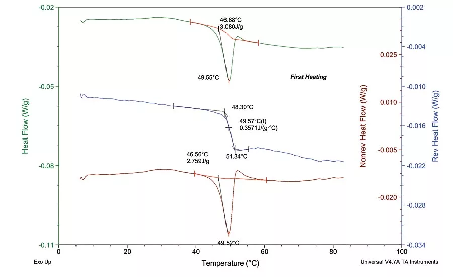

The thermal properties of the polymers were explored with MDSC. Compared to standard DSC measurements, MDSC offers the advantage of being able to separate thermal features into reversing and non-reversing events. MDSC showed that the thermal properties were relatively comparable across the set of samples. One important polymer property measured by both MDSC and DMA is the glass transition temperature, Tg. Tg shows the polymer chemist at what temperature the polymer transitions from a hard, glass-like material to a softer, more rubber-like material. This temperature is a key performance property of polymers. MDSC shows that the Tg’s for these polymers range from 38 – 52 °C. MDSC also showed that the heat of relaxation of these polymers ranged from 2.8 – 6.7 J/g on the first heating, and from 1.5 – 2.1 J/g on the second heating. An example DSC thermogram is shown in Figure 2. Specifically the total heat flow curve is the upper trace in Figure 2. The Tg is denoted by the step change in the reversing heat flow curve (middle trace). The peak in the non-reversing heat flow curve (lower trace) is a relaxation endotherm.

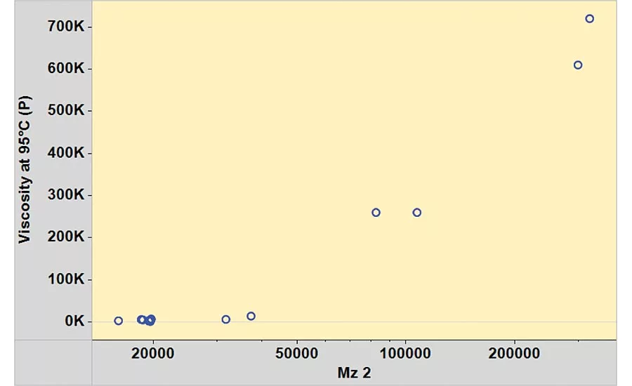

The polymer rheological or flow properties were measured using DMA. The DMA data shows that the polymers exhibit a single Tg, and the Tg values measured by DMA were consistent with those measured by MDSC. The largest property differences observed were in the complex viscosity above the Tg. Viscosities ranged from 1,000 to 1,000,000 P at 95°C. The lower molecular weight polymers exhibited a significant decrease in viscosity with increasing temperature. Likely because of molecular entanglements, the highest molecular mass polymers appeared more network-like.
By comparing the molecular mass results with the rheology results, the average entanglement mass can be estimated. Figure 3 shows a plot of viscosity (from the DMA data) vs. MZ (from the SEC data). The data in Figure 3 show the classic break in viscosity vs. MZ. The break point is indicative of the entanglement point. For these polymers it occurs at an MZ of about 30,000 D.
