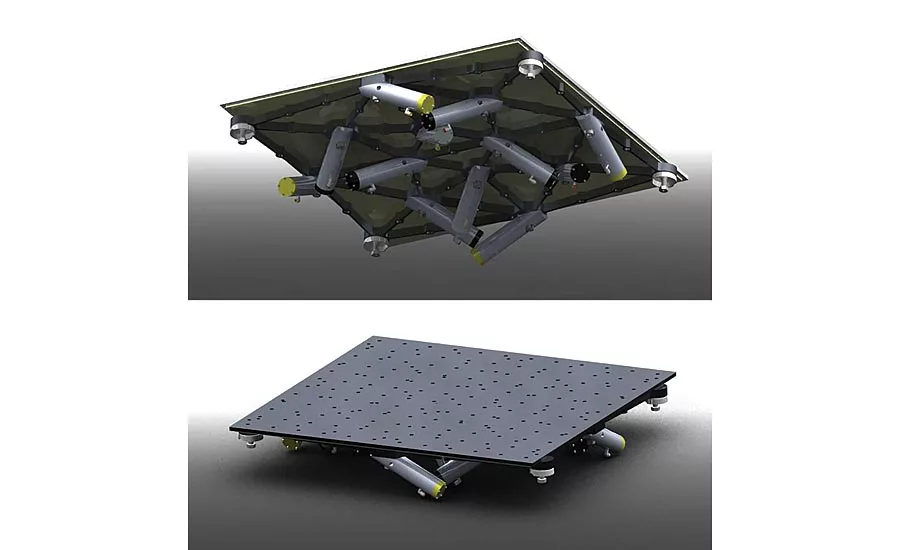

Given the significant differences in the purpose of the repetitive shock system, it must be radically different from an ED system. An intuitive understanding of the table behavior can be achieved by imagining a semi-rigid table with small jackhammers continuously beating on the bottom of it. Figure 2 shows the construction of a typical RS system. The actuators are mounted at an angle to the table surface, so each impact delivers a shock in more than one axis. They are also oriented to deliver shocks in different directions on the table. The UUT is secured to the top of the vibration table by special fixturing that is very different from the fixturing used on an ED machine.

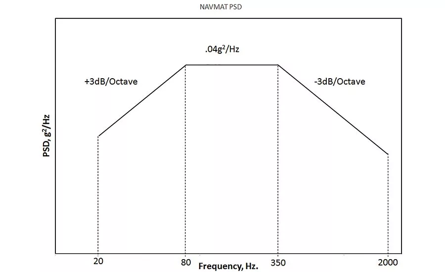

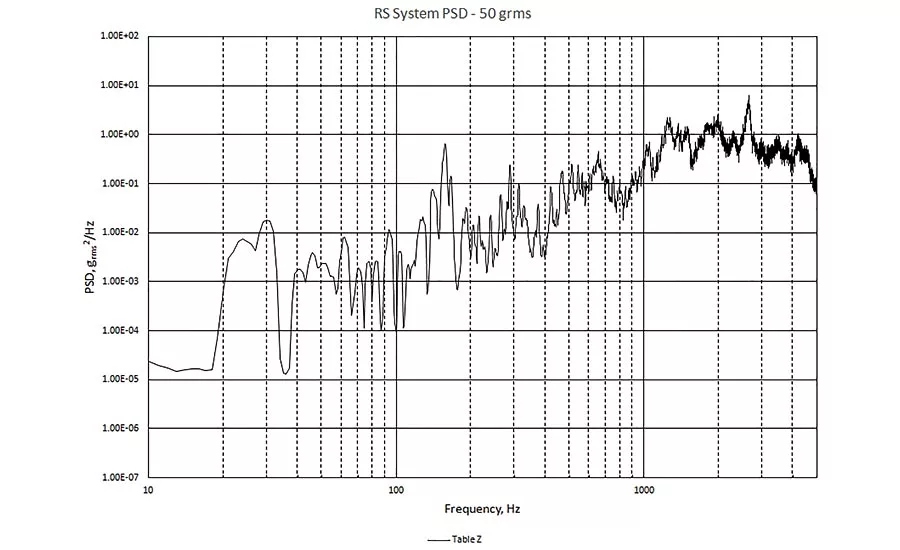

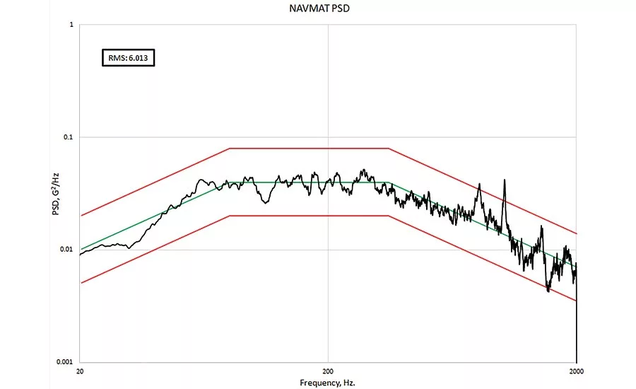

As stated above, the PSD of an ED system can be carefully controlled and shaped. The measured PSD on an ED system that is programmed to the NAVMAT profile is shown in Figure 3. The upper frequency limit of a larger ED system is typically near 2000 Hz, which limits its ability to excite the resonant frequencies of small electronic components (Henderson G. , 2009). In contrast, consider the PSD from the table top of a repetitive shock system (Figure 4). The shape of the PSD is not flat, as you would expect for a random signal. Also, there is significant energy above 2000 Hz in the system, increasing its effectiveness for fatiguing smaller assemblies and components with higher resonant characteristics, such as the SMT devices that are typical in technology today.

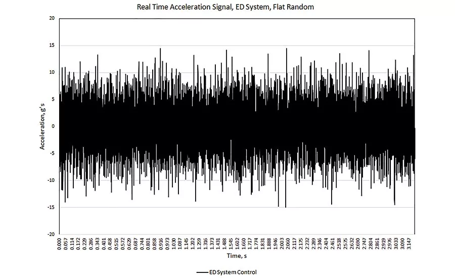

This difference in excitation is made clear when the real time acceleration signals from both systems are examined. Figure 5 shows the acceleration signal from an ED system during random vibration. A key feature to note is the fact that the peak acceleration levels stay within a 3sigma bandwidth. This is a typical characteristic of random vibration when generated by an ED controller (Fox Lang & Van Buren, 2007). In addition, the shaker has a limit on the maximum acceleration peak it can deliver without damage to itself, and the controller will intelligently limit the drive to the shaker to make sure this does not happen.

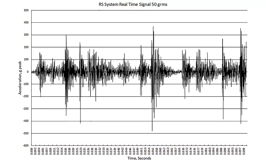

The real time signal from an RS system is shown in Figure 6. The first thing that is obviously different is the instantaneous acceleration levels. A sharp acceleration spike indicates when an actuator strikes the table, with the subsequent ringing and drop in amplitude being characteristic of the response of the table. The overlapping actuator strikes can be clearly seen. The measurement shown here is in the Z axis, perpendicular to the table top. Similar types of signals are seen in the X and Y axes as well (Henderson G. , 2009). In the repetitive shock system, the maximum instantaneous acceleration is much higher than in the ED system. The maximum level seen in this example is approximately 400 g’s, much higher than that achieved by the ED systems.

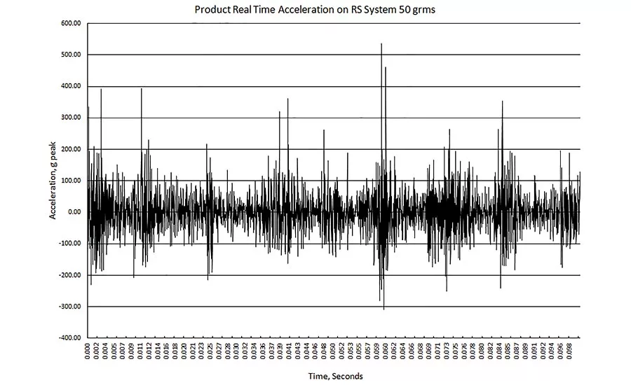

A more in-depth evaluation of the actual product response in the two systems reveals another key difference. With an ED system, the PSD gives a clear definition of the vibration input into the UUT. With an RS system, the PSD, measured at the table top, is only a part of the input. The shock that is delivered to the table is carried by the fixturing into the product itself. Figure 7 shows the time signals recorded on a product under test on a repetitive shock system. The spikes associated with the hammer strikes are clearly seen in these time signals. These spikes constitute a mechanical shock into the product, and the product will respond at its own resonant frequencies. It is quite possible that these frequencies will not be present in the PSD measured on the table top. Since fatigue occurs primarily at the resonant frequency of a device or component (Henderson & Piersol, 1995) this means that the shocks from the RS system will rapidly induce fatigue in a product regardless of the presence or level of those resonant frequencies at the table top.

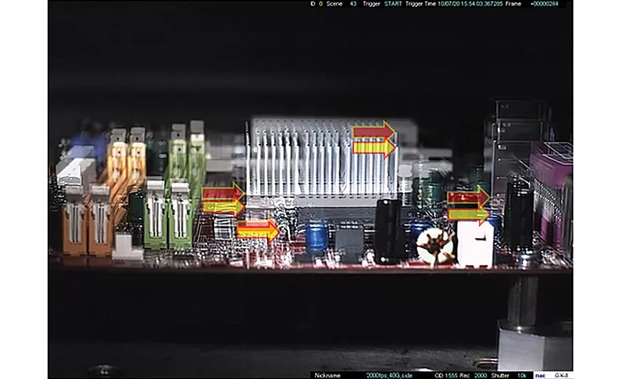

The complex and random product motion that results from repetitive shock excitation can make it difficult to intuitively understand the effects of the shocks on a product. This understanding can be greatly enhanced by analyzing high speed (5,000 fps) video of PCA and component motion on an RS system. (See the referenced video at https://www.youtube.com/watch?v=I4Jcf3YbaoA.)
When the motion of the PCA in a high speed video is compared to the driving excitation of the table top and fixturing, it is clear that the displacement of the table and fixture are very low, but the board’s response is higher. As the board flexes, strain is induced at the attachment points for all components. Extremes of the PCA’s motion are shown in Figure 8, which shows two, overlaid frames from the high speed video with key PCA locations indicated for comparison.
Motion analysis of the video allows the displacement of chosen targets to be tracked. The velocity and acceleration of those points can then be calculated. This analysis describes tracking results from three different points on the PCB being tested. These were the board itself, the top of a large electrolytic capacitor, and the front of a smaller sugar cube relay. The analysis allowed tracking in two axes simultaneously.

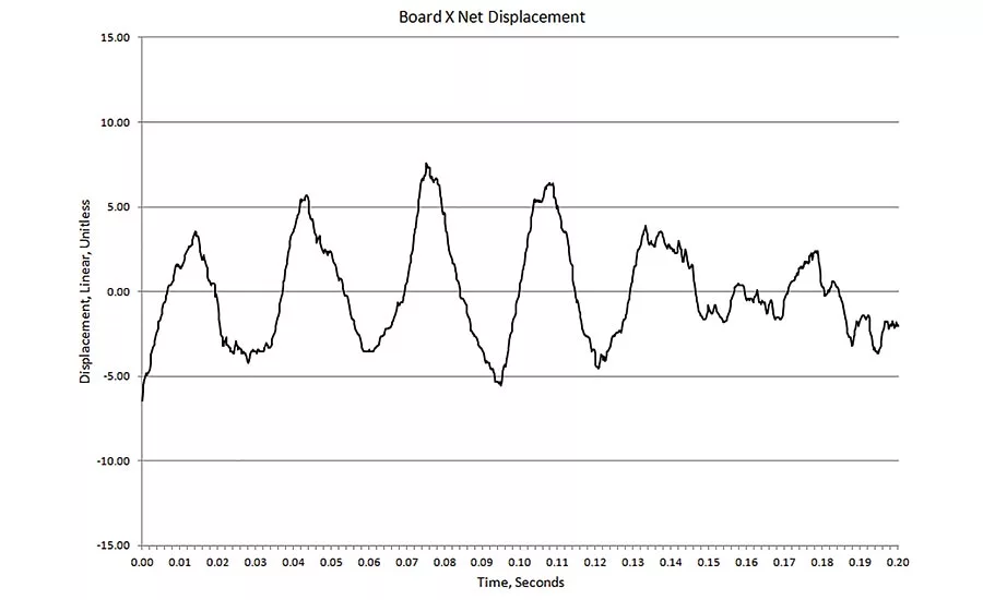

Figure 9 shows a graph of the resulting displacement data from the board itself. The shocks have induced large, slow excursions in the circuit card, even though those low frequencies were not present in the table top motion.

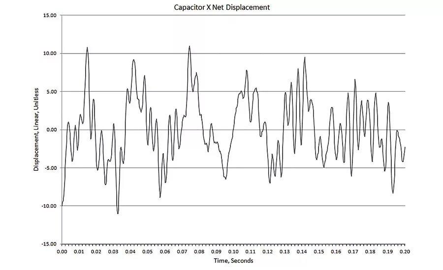

Figure 10 is a graph of the displacement of the large capacitor. The large excursions of the board are clear, but superimposed on these excursions is the resonant response of the capacitor.

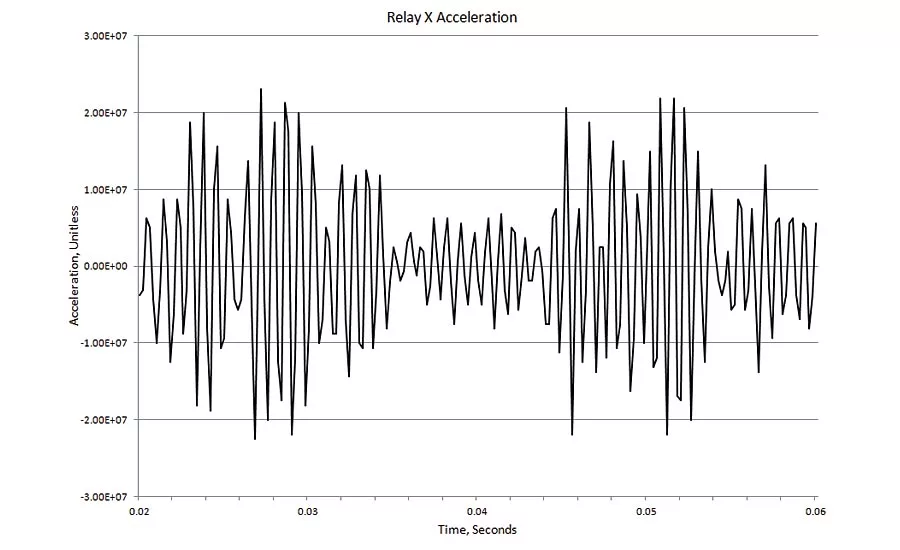

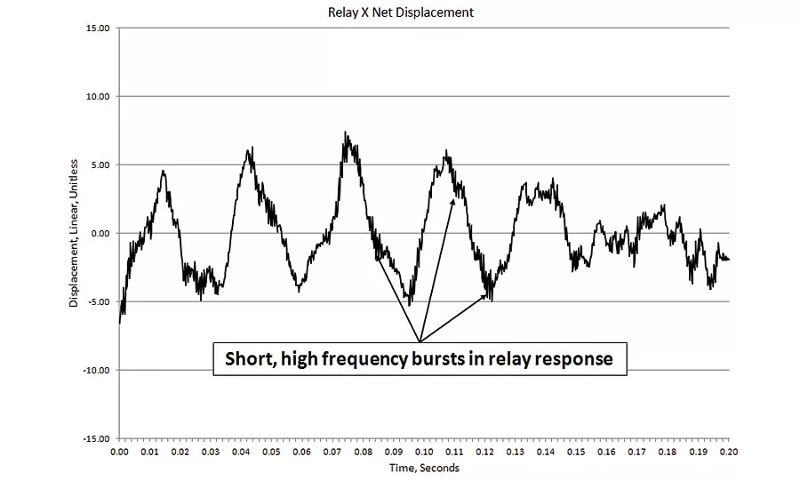

Figure 11 shows the displacement of the small relay. As with the large capacitor, the relay is moving with the board, and so shows the board’s displacement. However, the displacement of the relay includes short, high frequency bursts of motion at frequent intervals. Figure 12 shows the relay acceleration, calculated from the displacement data. It is clear from the waveform that the relay is responding to the shocks from the actuators with a sharp acceleration followed by a ring down. Because the relay is resonating at a higher frequency (~1300 Hz based on the acceleration graph), it has time to ring down between actuator strikes.

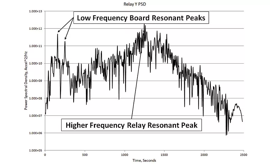

PSD graphs were created from the Y axis acceleration of the board and the relay. These are shown in Figure 13 and Figure 14. With this data in hand, the frequency domain characteristics of the board and relay can be examined.
The two low frequency peaks in the board PSD are likely due to the observed resonant response of the board in the displacement data. As expected, these two peaks are duplicated in the relay PSD, since the relay was moving with the board. However, the relay PSD clearly differs from the board PSD in the higher frequencies, showing a peak at 1300 Hz, coinciding with the real time acceleration data from the relay.

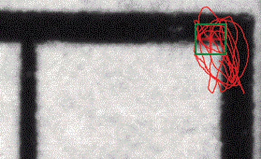

Another interesting observation can be made from the high speed camera video by looking at the differences in the component motion between ED and RS excitation. Figure 15 shows the tracking lines that resulted from tracking a point on an accelerometer mounted on a product on ED system. As expected, the point moved in a single axis. Tracking results of the same component on a Repetitive Shock system are shown in Figure 16. Although this analysis only shows two axes, similar differences are seen in the third axis. Clearly, the RS system is providing multiple axis excitation (Neill Doertenbach, 2015).
