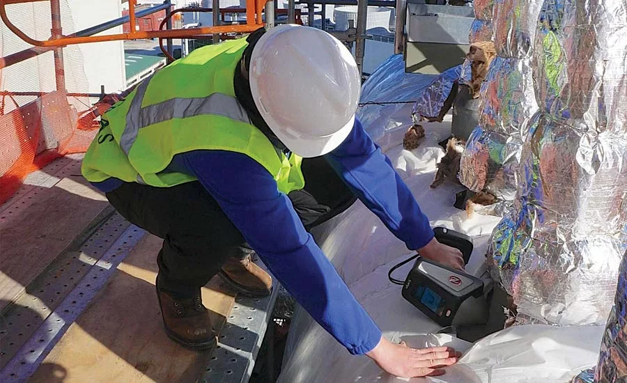

Although spark OES is considered a “portable technique,” it would be better classified as a transportable technique. OES instruments vary in weight and size depending on the manufacturer but can weigh upwards of 45-60 lbs. and requires an argon bottle that, depending on the size of bottle utilized, would also weigh about 20 lbs. The instrument and argon bottle are typically transported on a cart to help make the instrument mobile.  Because of the weight and size of this field mobile OES, working in elevated work areas or in ditches could require mechanical assistance to lift or lower an OES instrument.

As with OES, argon is still needed to analyze carbon in a LIBS handheld analyzer. Instead of an external argon bottle, regulator, and hose connection to the OES unit, the handheld LIBS analyzer uses a consumable argon cartridge integrated into the instrument, and with the analyzer’s battery, the instrument weighs four to six pounds, depending on the model. Sample preparation is still required for analysis, but the handheld size of the instrument, the grinder, and sanding discs can all be contained in a small case and transported to elevated working platforms, pipeline ditches, and hard to access areas with minimal effort, giving the user true in-field portability. As with OES, poor sample preparation will yield undesirable results. With proper sample preparations, the user can achieve fast, reliable, and accurate results.
