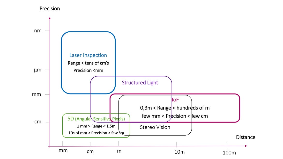

Part of the approach to addressing 3D Vision challenges is to start by mapping requirements into six key application domains:
  1. Vision Range - how far away is the target, what’s the required field-of-view, are there any occlusion issues?
  2. Depth accuracy and precision - how repeatable and reliable must depth sensing or measurements be?
  3. Image pipeline - what image format and frame rate are needed, and how will the data be processed (embedded System-on-Chip, or PC, or FPGA)?
  4. Scene characteristics - what are the features of the target scene? (indoor/outdoor, light sources, motion speed, potential interference sources, specular reflection, HDR requirements, etc.)
  5. Lighting specification - power, wavelength constraints, and eye safety compliance
  6. SWAP-C - are there constraints in Size, Weight, Power and Cost?
Figure 2: Teledyne e2v 3D Vision Solutions – the first order approach
Figure 2: Teledyne e2v 3D Vision Solutions – the first order approach. Image Source: Teledyne e2v
We’ll begin by considering the first two domains to narrow the list down to one or two techniques. The schematic above summarizes how 3D techniques can be mapped to these first two domains and shows how overlap exists in certain application areas.
The other four domains help resolve the overlap and narrow the list of techniques down to the one that will deliver the right product value. Once a technique has been identified, the next step is to find the right implementation of it.

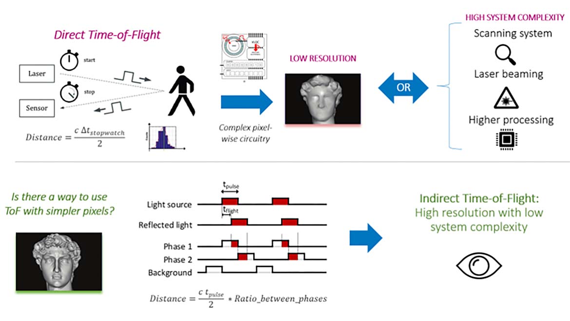

Figure 4: Direct and indirect Time of Flight implementations – difference overview
Figure 4: Direct and indirect Time of Flight implementations – difference overview. Image Source: Teledyne e2v
When looking at the implementation, ToF systems can be either direct or indirect. The main difference is that indirect ToF sensors, while providing generally lower performance at long distances (tens of meters), enable higher resolutions, making them a good fit for complex object identification.
This is why, when it comes to identifying objects in industrial environments, indirect Time-of-Flight can be an excellent choice. Finally, when it comes to the sensor component, the rest of the requirements mapped into the six application domains need to be taken into consideration.

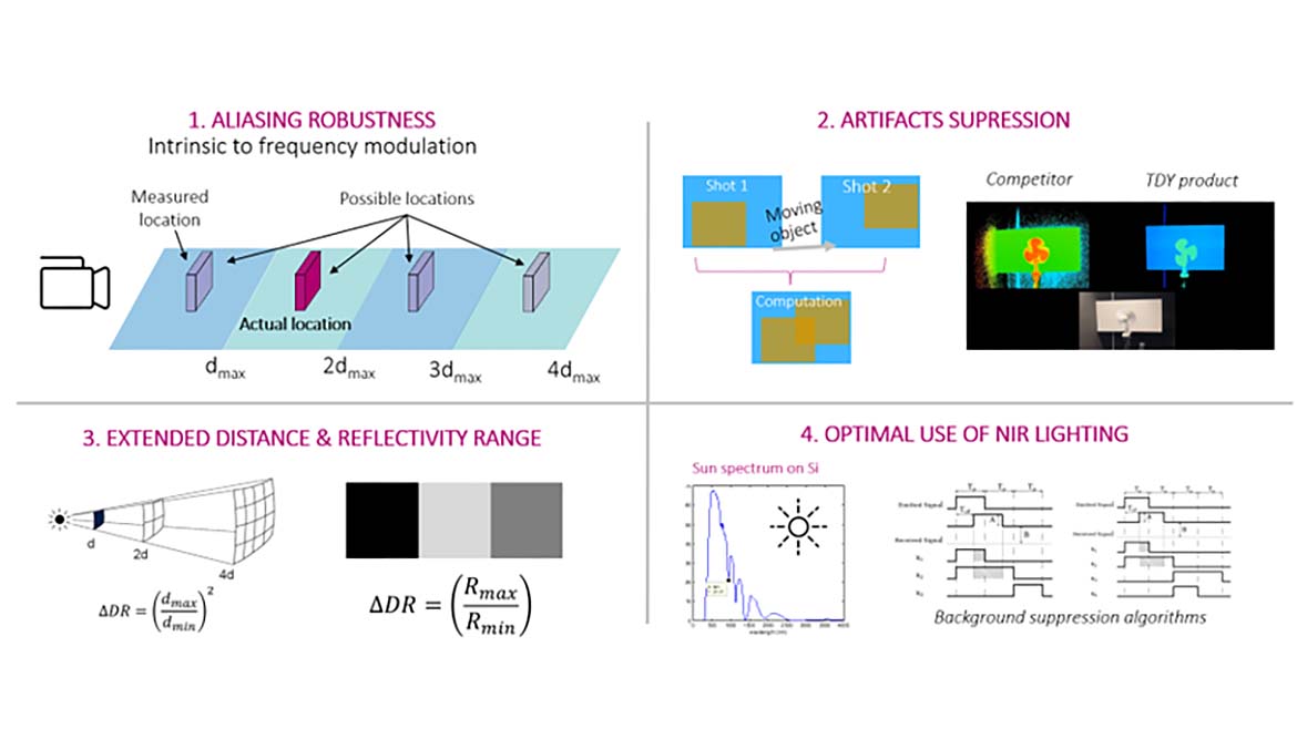

For this application, robots can operate in areas subject to ambient light or illumination coming from other systems, while also having to comply with stringent eye safety measures to take into account the presence of people. In addition, the objects to be detected may be moving (or the robot itself), and of different reflectivity.
Figure 5: Typical challenges where iToF sensors can provide differentiation. Based on Teledyne e2v's iToF solutions
Figure 5: Typical challenges where iToF sensors can provide differentiation. Based on Teledyne e2v's iToF solutions Image Source: Teledyne e2v
Selecting the right ToF sensor is key to properly tackling the above challenges. In this scenario, a sensor with a big pixel pitch (in the order of 10 µm) will enable the optimal use of light power (therefore making it eye safe), while still delivering a good performance. On-chip HDR features are also the key to supporting a wide diversity of object materials without compromising latency or frame rate.

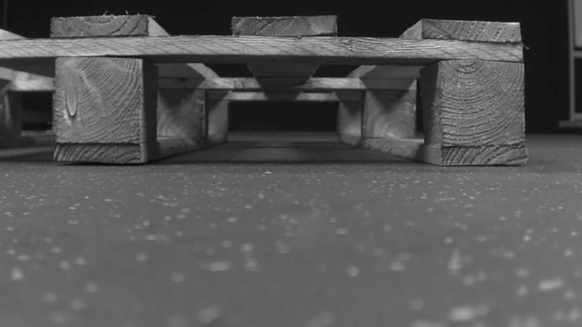

Another example of how depth sensing can provide innovation in logistics robot navigation is for docking systems. The use of vision for depth perception can enable implementation without additional infrastructure. For this application, the vision ranges are of a few centimeters, also requiring millimeter level precision.
Not many 3D Vision techniques can be mapped in this area, as stereo vision is limited for short ranges (objects are blurry below tens of centimeter ranges because of occlusion), and Time-of-Flight has the intrinsic limitation of saturating at too short distances (below 30-40 cm).
This is why we have engineered a passive technique to provide differentiating 2D + 3D depth sensing at distance ranges starting from a few millimeters up to 2 meters. This is called the Angular Sensitive Pixels technique. It provides sparse and denser depth maps based on contrast detection, on top of a 1,920 x 1,080 pixel 2D image. It uses no specific illumination and natively offers the possibility of direct 2D image fusion with 3D depth data. This technology is ideal for the pervasive deployment of more AI/ML processing at the Edge. Individual sensors and pre-calibrated imaging modules which encompass this unique innovation are already available on the machine vision market.
Figure 6 image on right: Short range imaging examples using Optimom5D from Teledyne e2v
Figure 6 image on the left: Short range imaging examples using Optimom5D from Teledyne e2v
Figure 6: Short range imaging examples using Optimom5D from Teledyne e2v. Image Source: Teledyne e2v
