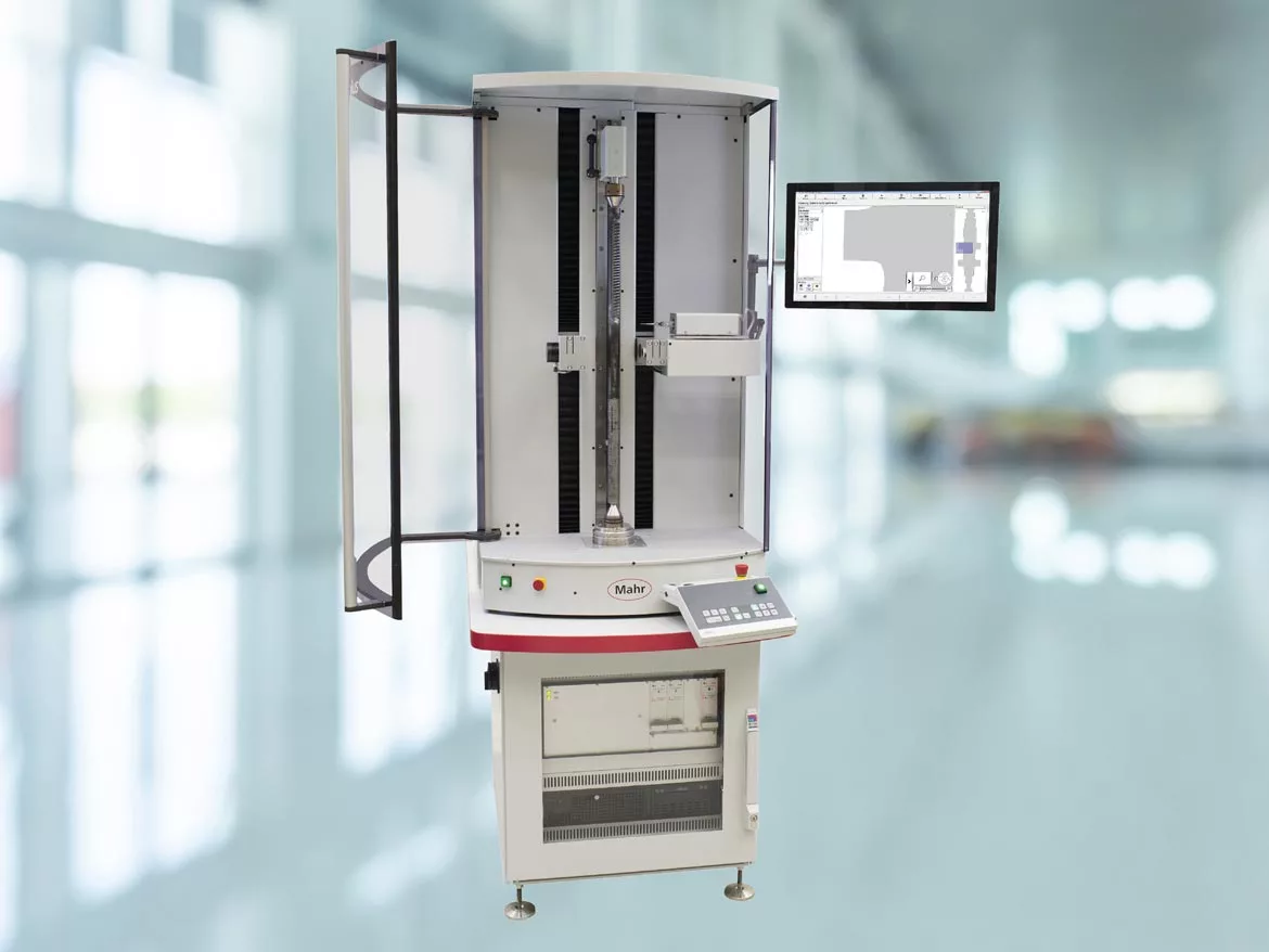

Shaft measurement can be performed with a variety of metrology tools. Source: Mahr

Specific shaft measurement systems can accomplish required tasks significantly faster than other tools, with more precision, and do so directly in the production environment. Source: Mahr

This solution has numerous advantages. With the combination of an optical and a 2D scanning probe, a shaft with dozens of diameters, lengths, fillet radii, chamfers and a typical helical gear can all be measured in 5-10 minutes, depending on the number of teeth checked on the gear.
