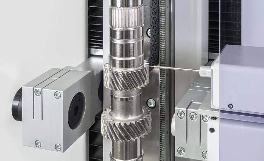

Measurement of a shaft with a gear on a multi-sensor shaft machine.

Despite the many benefits of optical technology, it can only see what is visible from the outside; the measurement process typically involves backlighting the part and obtaining a silhouette image for measurement. However, there are a number of elements that simply can’t be seen in silhouette.
For example, camshafts and gears naturally go along with shafts. The cams control the inlet and outlet valves in every combustion engine. There are also features such as keyways, shafts with splines on the end, gear teeth, and more that don’t readily lend themselves to optical measurements. Complete testing of these types of workpieces is becoming increasingly important because whenever tolerances are exceeded without detection, entire assemblies often break down.
To perform these required measurements, two separate machines, setups and processes have typically been used; an optical shaft measurement tool and a tactile measurement machine to handle all of the features that can’t be measured with the optical system. Today, there are new technologies emerging that offer a combination of optical and tactile sensors, including a high-precision matrix camera and 2D probe system. These enable the complete inspection of parts such as camshafts and gears in one setup.
This type of measuring solution has several advantages. The automated measuring procedure is much faster and much more reliable. While conventional coordinate measuring technology takes approximately 30 to 40 minutes per workpiece, this new technology can measure a four-cylinder camshaft in just five minutes, and a shaft with a typical helical gear in 5-10 minutes depending on the number of teeth checked on the gear.
Furthermore, the measuring station can be used directly in production at the machine tool for the respective machining operation. The motorized tailstock ensures that the workpieces are always clamped with the same clamping force and thereby eliminate operator influence. Furthermore, the system has complete 3D functionality as the tactile and optical measuring systems are calibrated together and operate in the same coordinate system.
