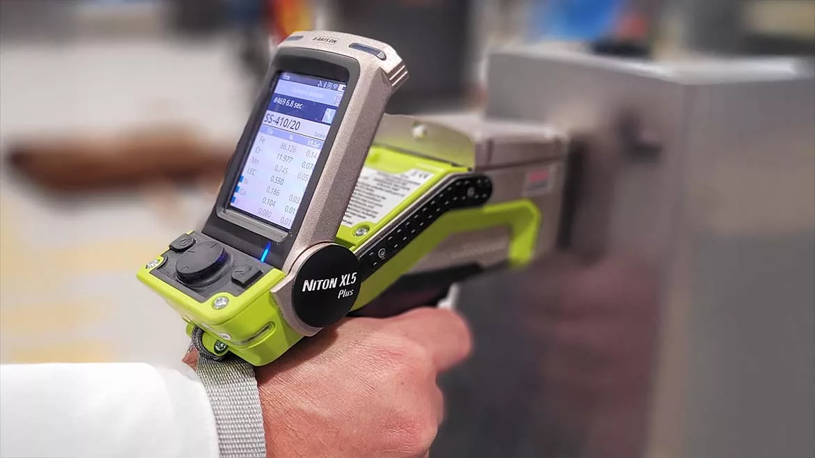

XL5 Plus analyzing hand angle view
Image Source: Thermo Fisher Scientific
Thermo Scientific Niton™ XL5 Plus Handheld Analyzer verifying grade requirements.

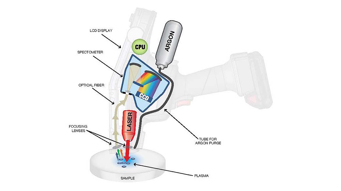

Similarly, handheld LIBS analyzers, such as those that use a high-powered laser to create a plasma on the sample's surface, analyze the emitted infrared light spectrum to detect elements, including carbon.

LIBS
Sketch of handheld LIBS technology.
Sketch of handheld LIBS technology. Image Source: Thermo Fisher Scientific
