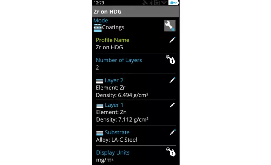

A1: Defining sample parameters. Entry of composition of substrate and coating layers. Image source: Thermo Fisher Scientific

Although the fundamental parameter approach is versatile, it is required to know and define the composition of the substrate, the sequence, and composition of layers before performing the analysis. Data can be entered via the user interface of the instrument, as is shown in the example of figure A.1. In this first example, the substrate is made of a low alloy steel, the first layer is made of zinc and the second is a thin layer of zirconium. This type of galvanized steel coated with zirconium is used among others for car body panels. The layer of zinc prevents the oxidation of steel, while the layer containing zirconium further increases corrosion resistance and ensures better paint adhesion.
Next, one measurement was carried out without previously measuring any calibration standards. The results of analysis for the layers of zirconium (Zr: 40 mg/m2 ) and zinc (Zn:82723 mg/m2) match well respectively with the value determined using laboratory techniques for Zr (38 mg/m2) and the expected value for Zn (80000 mg/m2) as it can be seen in figure A2. The accuracy could possibly be improved further based on type standardization, by empirically adjusting the response of the analyzer to the known values of analytical calibration standards if deemed necessary.
