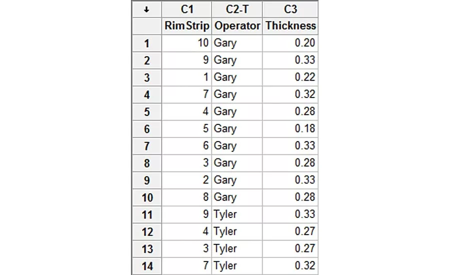

In the following example, three operators have measured the thickness of ten bicycle tire rim strips two times each. Note that each operator measured the parts in random order to minimize external factors.

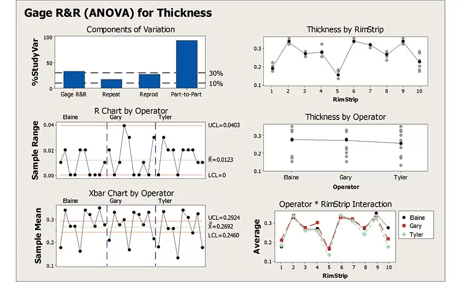

We can use the Gage R&R results to assess the measurement system. The Components of Variation graph shows the amount of variation contributed by the Gage R&R combined, repeatability, reproducibility, and the part-to-part. Typically, a Gage R&R %Study Variation less than 30% is acceptable, while less than 10% is ideal.
In this analysis, the %StudyVar for Gage R&R is greater than 30%, with reproducibility being the largest contributor. Therefore, the measurement system needs improvement and the system may not be able to distinguish between parts.
We can use the other graphs to figure out why the Gage R&R %StudyVar is larger than desired. For example, the Thickness by RimStrip and Operator*RimStrip Interaction plots show a greater amount of variation between the operators’ measurements for the tenth rim strip, which contributes to the poor reproducibility results. However, the R Chart, which can be used to identify repeatability issues, is in control. In addition, the Xbar Chart is out of control, which is also favorable. This indicates that there is more variation between the parts than when the same operator measured the same part repeatedly.

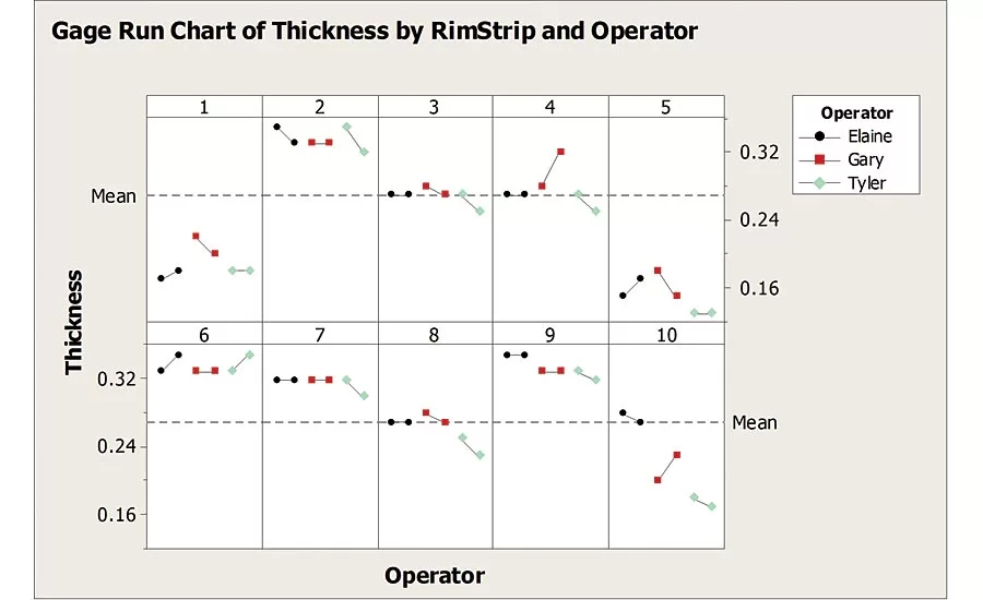

The Gage Run Chart is another tool that can be used to identify measurement system issues.
This chart again shows that part 10 was particularly difficult to measure. The Gage Run Chart will also reveal patterns in the data. In this analysis, we can see that Tyler almost always measures the rim strips smaller the second time, which would have gone undetected if we relied solely on the Gage R&R results.
The Gage R&R Study shows that the measurement system used to measure rim strip thickness needs improvement. Perhaps there were certain attributes of part 10 that made it difficult to measure, and the Gage Run Chart indicates that Tyler may have used a different procedure when measuring the rim strips a second time. There are many causes for inadequate measurement systems, including issues with the measurement device itself, an operator who was not properly trained, or a measurement tool that exhibits wear out after repeated use. Whatever the case may be, evaluating your measurement system is crucial; only then can you uncover measurement system issues and build confidence in your data.
