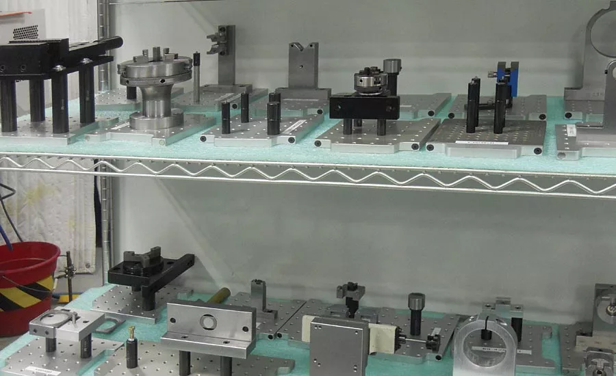

However, the addition of the equipment rarely includes effective fixturing. For example, many manufacturers that I visit forego fixturing due to the expense, lead times, or its functional limitations. In many cases, shops assume that they can make inspection fixtures for less money than purchasing a more readymade solution. This may not be the case with today’s world.
A few years ago I found a fixture system that I could recommend to resolve many of the eight (8) wastes. Let’s examine how a unique fixture solution that is both effective and affordable, can improve customer satisfaction and profitability from spindle to inspection and back again.
The Inspection Arsenal System and the Eight Wastes of Lean
Inspection Arsenal™ is the only Lean universal fixturing system that provides a complete line of tools simple enough to be used by both machine operators and inspectors anywhere in the manufacturing process.
Key features include a modular and magnetically interlocking quick-swap technique available with multiple sized docking rails and fixture plates that adapt to your equipment and unique applications. Many of the unique non-marring work holding components have a trigger-action or air-assist feature for quick-swap of parts. Machine operators and inspectors can quickly and easily be trained to use this simplified fixturing system that can be used across all inspection equipment.

Manufacturers have perfected shop floor fixtures that cut machining time. Now, similar fixturing practices can be accomplished easily in inspection. Implementing a system that includes off-the-shelf, ready-made plates offers the ability to create simple and low-cost dedicated fixtures.
Fixtures can be checked on any inspection equipment that is available. Inspectors or operators can move fixtures from one machine to another, companies can employ CMM palletization features and set large part lot to run lights-out.
Linda Tool of New York makes use of inexpensive dedicated fixtures to swap setups quickly. “We create a simple fixture for each of our long-running jobs that we quickly swap in and out for a much faster inspection process. You’ll see several of our fixtures here — at least 35 unique fixtures — that are marked per the job to make retrieval and setup fast. We inspect the parts during the run. The machine operator will take the fixture, assemble the part and call the program up and inspect them. The learning curve was very fast, as well,” said Shlomo Mordechai, quality engineer.
Culver Tool and Engineering of Plymouth, IN, enhances the investment of their small CMM with quick change-overs and reduction of manual alignments.
“Our machines have a small table, so we keep a lot of fixtures mounted on these plates.  They give us the capability to quickly swap fixtures and locate with accuracy so that we don’t have to do another manual alignment.  Use of Loc-N-Load™ plates saves us a lot of valuable CMM time,” said Brandon Tanner, CMM programmer.
“Inspection Arsenal™ Loc-N-Load™ plates have been a key component in implementing new equipment. This is an all new implementation for our company so time studies are not complete. Like Brandon said though, the ability to just place a fixture and go has done wonders in taking the burden off of the CMM operator having to do manual alignments for each part we run,” said Deven Berger, continuous improvement manager.
