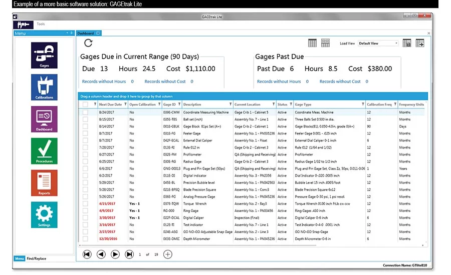

Example of a more basic software solution.

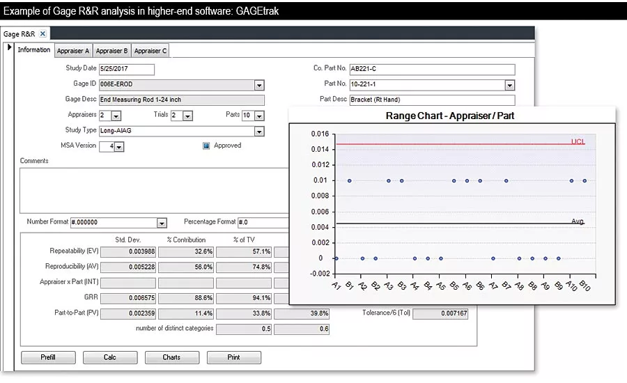

Example of Gage R&R analysis in higher-end software.

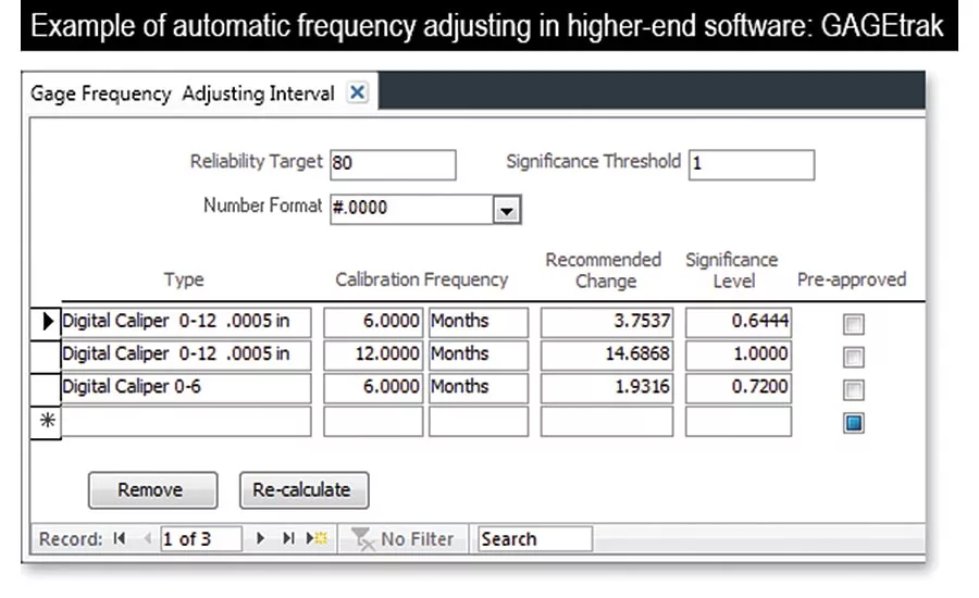

Example of automatic frequency adjusting in higher-end software.

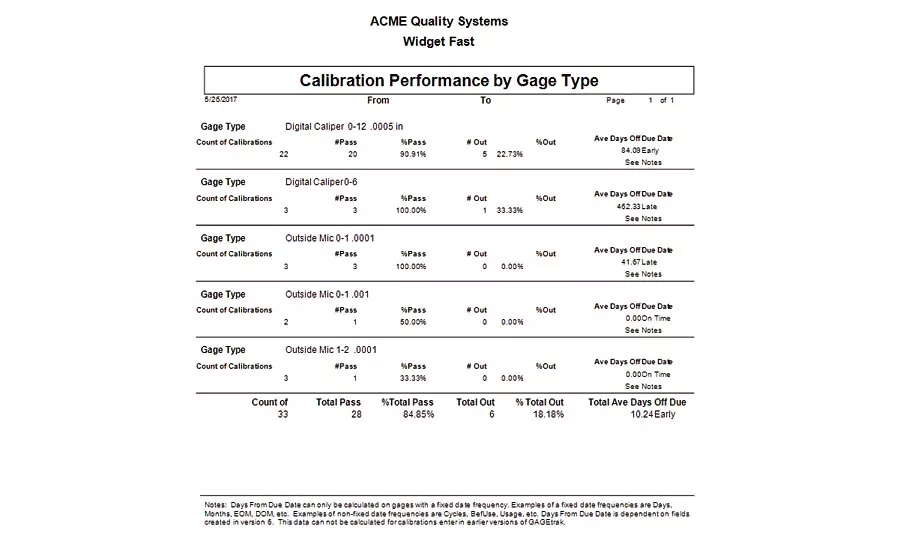

Example of calibration reporting in higher-end software.

When it comes to measurement and test equipment, the most important information for which the auditors are looking is calibration and usage performance history. In the end, the company’s personnel must know where a gage is at any one time, where it has been, when it’s due for calibration and what its last status was. This is a great deal of information that must be made immediately accessible, all in the moment the auditor requests it.

Even the most basic gage management software will streamline your workflow, reduce errors, track gage locations and help in monitoring scheduled and unscheduled calibrations.
On the higher-end packages, team members will be emailed when gages are coming due or for critical events such as out-of-tolerance conditions or failures. You will be able to link blueprints or instructional documents to gages, calibrations and procedure records. You can maintain standards traceability, enforce calibration procedures and even employ advanced statistical analysis tools such as Gage R&R (repeatability and reproducibility) testing for your entire measurement system.

Commercial software applications allow users to quickly recall a gage’s calibration history and mine that data with a couple of clicks. This is especially critical for effectively monitoring calibration intervals. These intervals are often based on manufacturer recommendations, but an instrument’s past behavior, its frequency of use, environment and how critical it is to product quality may require you to deviate from original recommendations in order to achieve a more stable calibration interval.
While this is certainly possible to track with a paper record, commercial software written for compliance will easily track gage performance and provide more comprehensive calibration data with far less effort.
