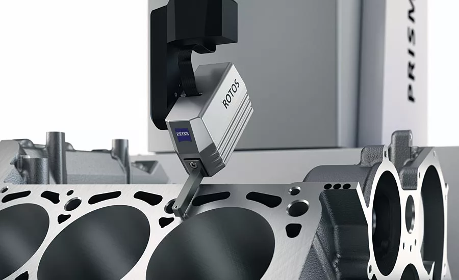

Roughness and waviness inspected on a CMM. Source: ZEISS

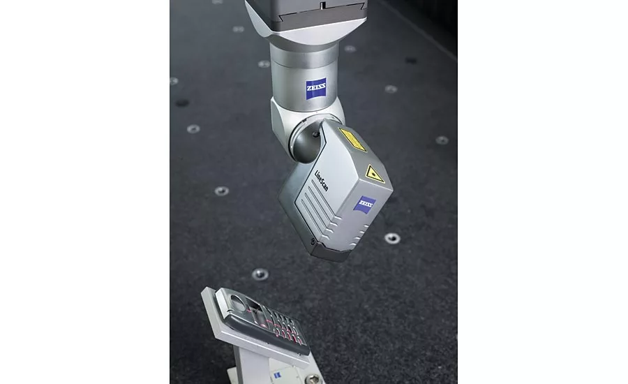

Softer materials are measured optically on the CMM using various forms of light.
Softer materials are measured optically on the CMM using various forms of light. Source: ZEISS

Soft materials could be distorted or damaged by a firm touch, thereby lowering yield or providing inaccurate measurements. To avoid distortion, these materials are measured optically using various forms of light.
Form measurement looks at factors like straightness, roundness, cylindricity, contour, and surface roughness in high-precision parts with very tight tolerances. It is often used with complex geometries and small parts and requires different software from that used with traditional CMMs.
