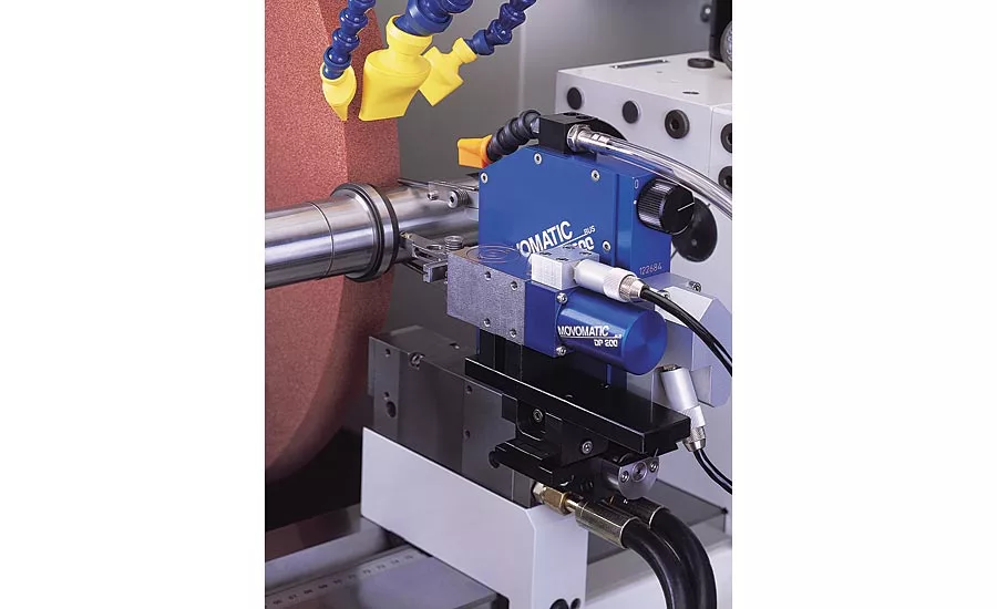

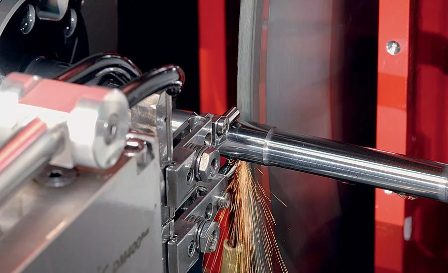

In-process gaging for this discussion is the continuous measurement of the workpieces during the grinding process in the work area of the machine. The grinding process can be controlled and optimized dependent on the measured parameters. Internal grinding, match grinding, flat grinding on precision parts including shaft, turbo-chargers, pistons, injector components, and hydraulic valves can hardly be successful without an in-process gaging system to measure, collect part data, and provide that information to the machine to optimize the manufacturing process as it is happening. In this way, scrap can be avoided, production interruption can be eliminated, and piece cost can be controlled.
Over the last couple of decades, increasingly higher tolerance requirements have mandated development of in-process measurement systems for O.D. and I.D. grinding applications. These systems locate workpieces, identify and control grinding wheel in-feed rates, measure and control part size, and help compensate for wheel wear. In-process measuring and controlling the machine tool’s operation with that data has greatly improved the quality of the parts produced. This is increasingly important as tolerances on the parts continue to become tighter.
Before the advent of these types of measurement systems, grinding parts was kind of like playing roulette, in that you never knew precisely what the finished size was going to be. The introduction of in-process measurement equipment eliminated gambling from the grinding process, allowing faster production of parts while delivering much better accuracy on the finished product.

A typical in-process system consists of the following: one or more measurement heads, gap control device, hydraulic or pneumatic slide, industrial controller, and possibly a human machine interface (HMI). Up until a few years ago, in-process systems were 100% analog in function and data transmission.

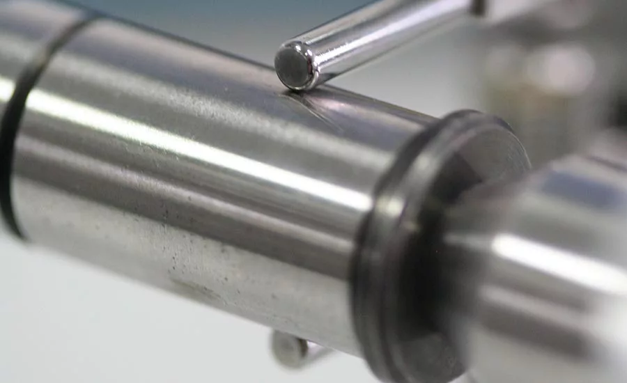

Consistent measuring accuracy that can provide high repeatability based on thermal and mechanical stability of the gage heads and highest process reliability even for the smallest workpiece tolerances.

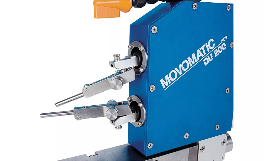

Mechanical crash protection through defined breaking points on the measurement jaws, preventing damage to the probe, part and machine. Gage heads should provide large measuring ranges.

Easy to integrate into the machine tool, set up and install or retrofit to existing machines with control of all measuring functions through a single cable.

Grinding machines today are quite capable by themselves, having the ability to grind parts to within approximately ±0.00006”, but they can’t do the job alone as tolerances continue to get tighter. State-of-the-art in-process measurement systems can assure grinding machines operate to their best possible capability, creating a system capable of delivering accuracies down to ±0.00001” (0.000254mm). This allows much greater control over the finish grind of critical parts such as fuel injector components, valves, shafts, etc.

Grinding cycle management is another important way in-process gaging can improve quality and productivity. To save time in a typical grinding cycle, the wheel approaches the workpiece rapidly using a gap control device to prevent wheel over-travel. At some point in the approach, the in-feed rate changes to the coarse grind rate, allowing the machine to remove a predetermined amount of stock. During the coarse grinding process, pressure between the wheel and the workpiece causes the workspace to flex slightly, so the in-process gaging system switches the wheel to a fine grind in-feed rate, which minimizes any part flex that might occur.
