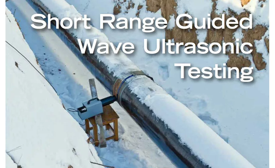

Short range guided wave testing (SRGWT) is an application of guided ultrasonic sound waves using special types of probes. When the guided waves hit the discontinuities, the mode converted sound is reflected back and received by the transducer.
The major benefit of this technique is that it can be used to detect corrosion on plates and pipes that are inaccessible due to support structures, braces, brackets, saddles, legs, under insulations or other types of obstructions in the way of the region of interest. Another application is steel structures coated or surrounded by concrete.
Difference between Short Range Guided Wave and Long Range Guided Wave Technique
There are multiple other techniques available that utilize Guided Wave principle such as the long range guided wave technique (LR-GWT). While LRGWT can provide corrosion inspections over great lengths of test objects, it uses low frequency waves to achieve long distance penetration, compromising on the sensitivity and resolution. Whereas, since SRGWT is a short range technique, it allows us to utilize higher frequency sound waves resulting in much higher sensitivity and resolution.
A specially designed ultrasonic transducer is used to generate short range guided waves. The probe is usually scanned over a region that is easily accessible and clean of surface irregularities, facing in the direction of the region of interest which is usually inaccessible due to support structures or pure geometry of the test object. The scan range of this technique is up to two meters.
