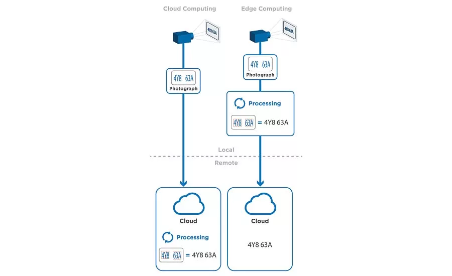

Fig. 1. In the edge computing paradigm data is processed locally.
Cloud vs. Edge Computing
To illustrate the difference between cloud and edge systems, consider the example here.
In the cloud paradigm (left), a camera sends a photo of a vehicle with a license plate to a server, and the server then reads the plate number. The server is responsible for data processing.
In the edge paradigm (right), the camera reads the license plate number, then sends only the plate number to the server for identification. The camera is processing the data at the edge.
