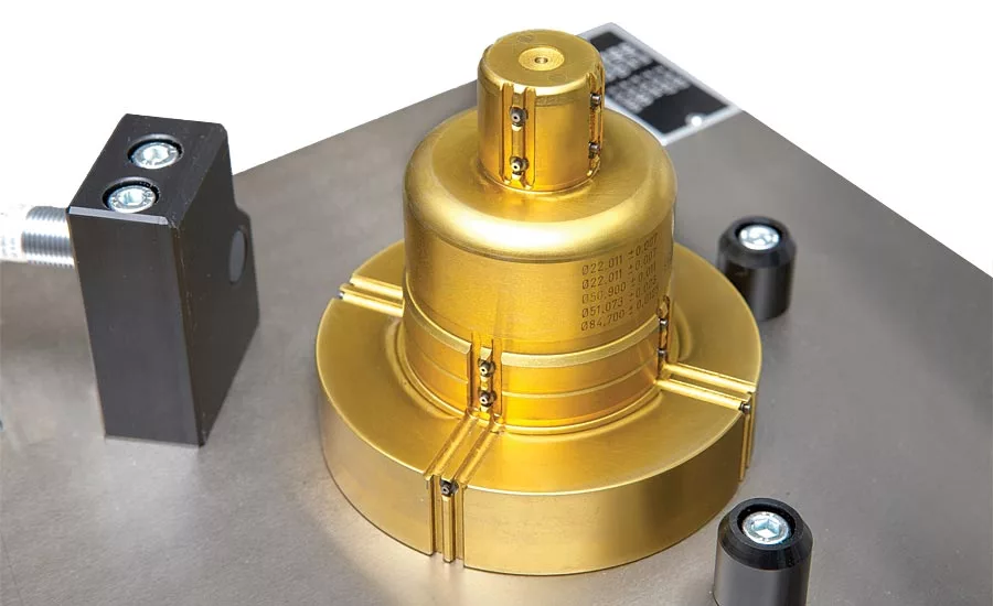

A multi-circuited air probe is shown here.

So how could air gaging fit into this environment? Isn’t air gaging basically used as a go/no go gage to simply check if the parts are good or bad? The answer: not anymore. Air gaging has evolved with the demands of customer requirements and is being used in fully automated measuring stations to perform 100% inspection and provide feedback to the machine tool for offsetting. The air gaging rings and probes haven’t changed much over the years except for being able to measure smaller and smaller diameters. The major advancements have come in the control units. They are often referred to as comparators, columns, or measuring computers. These devices can have digital inputs and outputs, analog inputs and outputs, Ethernet, Profibus, USB, RS232 and many others. These communication protocols allow for the gages to function in semi-automatic or fully automatic measuring modes including calibration.

Here is an example of how the measuring procedure could be set up. The first thing that would happen is the calibration of the gaging system. This can be done either manually or automatically. Typically, if it is done automatically, the MIN and MAX masters will be in the form of the workpiece being measured. This makes it much easier for the robot to load the masters onto the gage because the robot is already configured to pick up and load the workpieces. In either case, the MIN master is loaded onto the gage and then either the start button is pushed manually or is triggered from the PLC (programmable logic controller) through one of the communication protocols such as the digital input/outputs. The MIN calibration can then be stopped through several procedures. You could manually press the stop button, or it can be triggered through the digital input/output or a countdown cycle could have been started from the start procedure. You would then remove the MIN master from the gage and place the MAX master on the gage and repeat the cycle. This calibration cycle can be controlled either using a timer to trigger the cycle, a parts counter, manual trigger, or some other trigger. Calibration is typically done one time per shift, but some customers require it more or less frequently.
