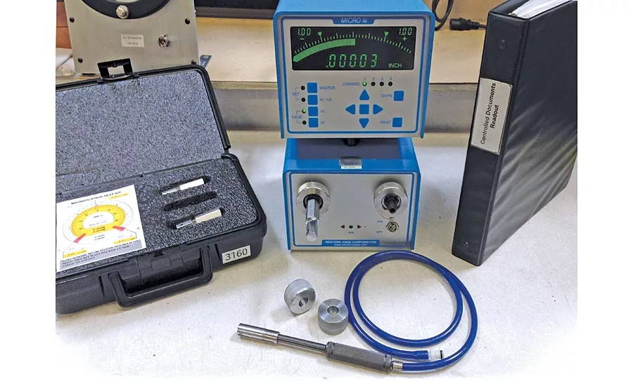

Here is a calibration setup with a readout, air gage member, orifice set, setting master and documentation. Source: Western Gage

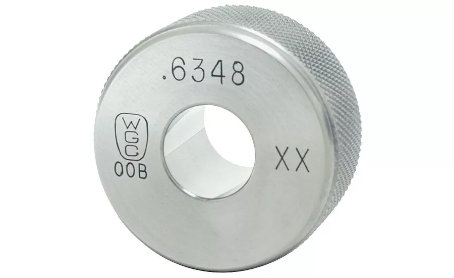

Setting masters are the reference standards used for the calibration of air gage systems. Source: Western Gage

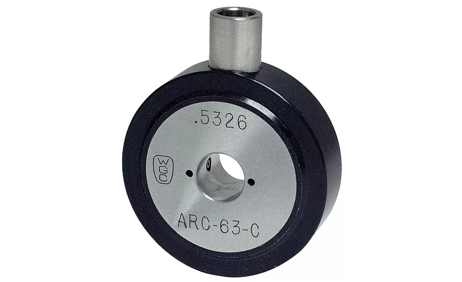

Air gages are a comparative type of measurement device. Here is an air ring member. Source: Western Gage

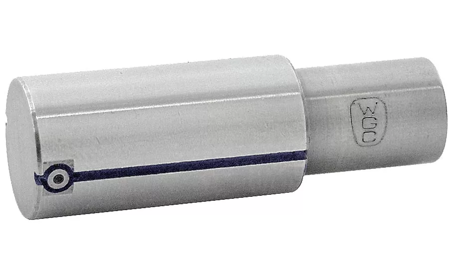

Your air gage supplier should be able to assist you with your air gaging maintenance and calibration needs. An air probe is shown here. Source: Western Gage

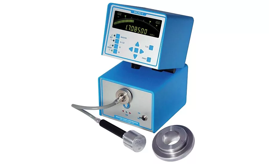

The basic components of any air gage system include the air gage, setting master(s) and electronic/pneumatic readout. An air gage system with readout, air gage member and setting master is pictured here. Source: Western Gage

The basic components of any air gage system include the air gage, setting master(s) and electronic/pneumatic readout. Each one of these components will require periodic calibration by in-house personnel or by an outside laboratory, both of which must meet the quality system’s requirements.

Air gages are a comparative type of measurement device. They operate in a two system world: single master and dual master systems, where each requires the use of one or two setting masters respectively, to either set the zero offset or to set the gain. The term “calibration” has been used very loosely to describe these two operations.

Dual Master Air Gage
The dual master air gage system is considered a “calibrate at time of use” gage. A calibration on a dual master system can be performed when all the elements listed above are in place. When the above elements are not in place, the more appropriate term for describing the steps involved with using a dual master gage is “mastering,” not “calibrating.” Mastering is simply applying two reference standards to set the gain. Mastering should be performed periodically to adjust for environmental effects or as an intermediate check between calibrations. However, when a new gage is set up or a significant interval of time has passed, “calibration” of the dual master gage is called for.
Dual master systems can be calibrated with the two masters that are typically ordered with it. However, calibrating with the same two reference standards that were used to “master” the instrument has its drawbacks. Under certain conditions, scaling errors can be masked. In addition, a two point calibration does not reveal linearity errors which can be significant in wide range measurements. To really know if your gage is accurate, a third data point is necessary.

Single-master readouts are best calibrated independent of the air gage member (tooling). Calibration is performed with flow restrictors that simulate the “standardized” tooling. The flow restrictors (orifice sets) come in sets of three. Two orifices are used for mastering (scaling) of the readout while all three are utilized for calibration. The orifice sets themselves are calibrated with traceable reference standards—meeting the quality requirements of traceability. Orifice sets can be purchased and used by the end user but are more commonly used by the manufacturer in the factory.

The gaging member (tooling) of a single-master system also requires calibration. This ensures that the entire system, meaning the readout and the tooling, is operating accurately. Use of the one master which is typically purchased with the single-master tooling is appropriate for “mastering” (“zeroing”) the instrument and this should be done periodically to account for environmental changes. However, using just that one master for a single point calibration is insufficient. At a minimum a second master which provides a second data point should be used.
A single data point calibration checks that the zero offset is set correctly; two data points enables a measure of the zero offset and gain; three data points evaluates the zero offset, gain and linearity. The more data points, the better the calibration. However too many points eventually adds no more value and increases the cost.
A good rule of thumb for the number of data points needed as a minimum to calibrate an air gage is: one reference master above the system type. So a single master system would require two setting masters and a dual master system would require three setting masters. This minimizes the cost of the masters and provides an acceptable level of confidence in the calibration.
Setting Masters
Setting masters are the reference standards used for the calibration of air gage systems—typically rings, plugs and set discs conforming to ASNI/ASME specifications. Setting masters undergo the same rigors demanded by the quality system as air gages. The setting master calibration certificate number is referenced on the air gage calibration certificate to fulfill the traceability to a National Measuring Institute (NMI), e.g. NIST, requirement.
Air gage calibration acceptance limits are set based on the product tolerance, or alternatively on the manufacturer’s gage specifications. When based on the product tolerance, a 10% or less acceptance limit should be used; 5% is a better number. A .002” product tolerance would translate to a .0002” calibration acceptance limit—and the accuracy of the masters used to calibrate the gage should be 10% or less of that, or .00002”. When manufacturer’s specifications are used, the acceptance limit for calibration should be less than or equal to the manufacturer’s accuracy specification.
