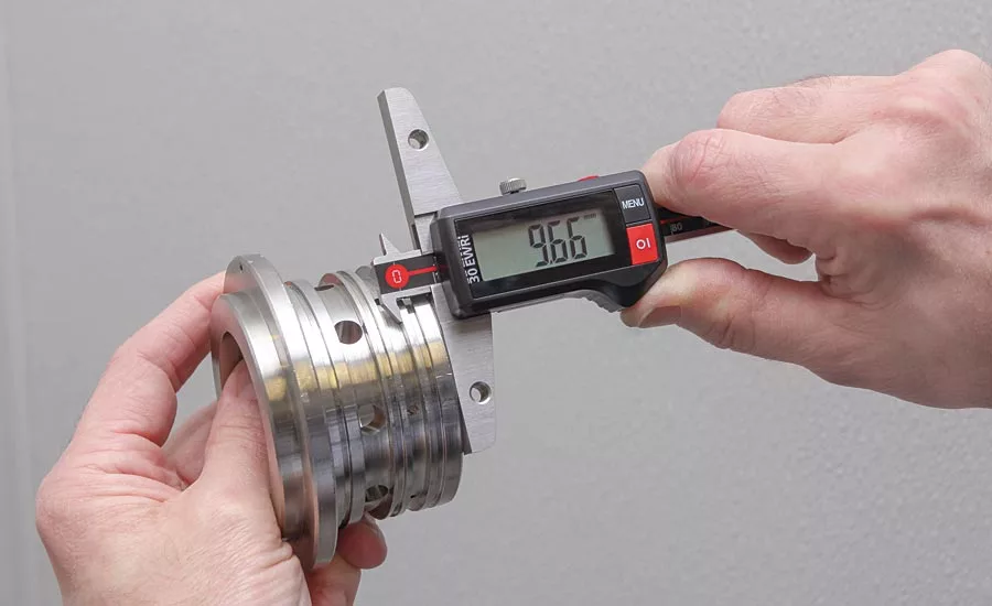

double hook digital depth gage
A double hook digital depth gage allows for not only checking the location of a top or bottom surface of a groove but can be used to measure the groove width. Source: Mahr

Digital depth gages
Digital depth gages are a versatile tool for checking depths in a wide range of gaging applications. Source: Mahr
