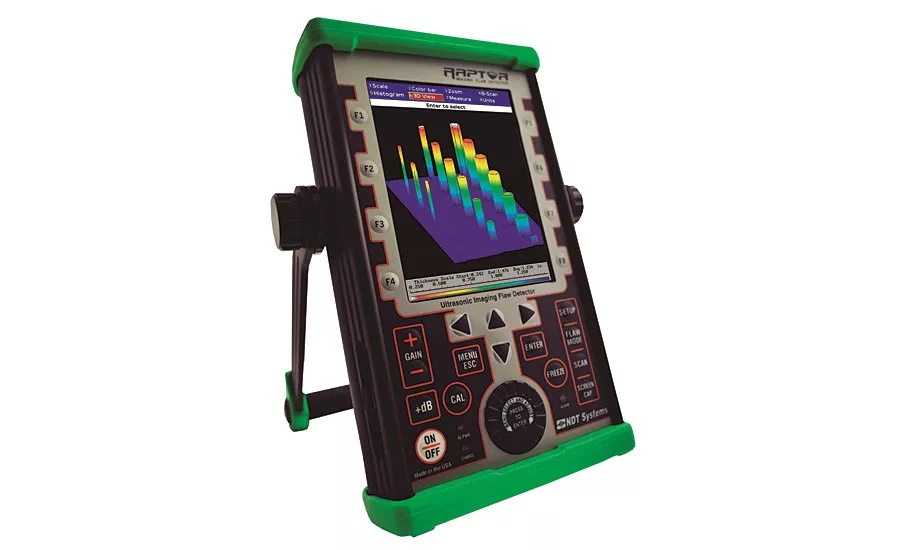

Ultrasonic flaw detectors
Ultrasonic flaw detectors observe the soundwave as it reflects off internal flaws which change the predictable sound pattern within the piece of metal, plastic or other material. Source: NDT Systems
