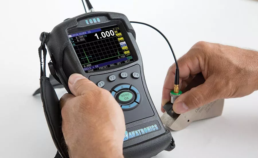

The primary reason for using an ultrasonic thickness gage is you can nondestructively test the wall thickness of the material without destroying the part. Source: Danatronics

Ultrasonic testing and the use of thickness gages using ultrasound is a very well-known technique. The primary reason for using an ultrasonic thickness gage is you can nondestructively test the wall thickness of the material without destroying the part. Commonly the two primary uses are for detection of wall thinning due to corrosion or as a quality control tool for material thickness consistency. The applications range from measuring pipes, tubes, boilers, ship hulls-considered corrosion to plastic bottles, toys, coil steel, aircraft aluminum and coil steel-considered precision, to name a few.

One common example of this is a technique referred to as echo to echo. Here is the basic application and solution. Many times parts such as a storage tank or steel ship hull are painted. When using an ultrasonic thickness gage without the echo to echo feature, the thickness of the paint will introduce an error of roughly 2.5 times the thickness of the paint. The reason for this is the sound speed used to measure the base steel is 2.5 times faster than paint. So a .010” (.25mm) thickness of paint will introduce a .025” or .625mm error. The echo to echo technique offered by many manufacturers measures the time between two successive backwall echoes in the base material thus taking the paint thickness out of the equation.
Some consideration should be given to the thickness of the base material as most vendors will state the base material should be at least .100” or 2.5mm in echo to echo mode. Also consider a more heavily damped transducer and ideally viewing the live waveform to verify the echoes are legitimate is recommended. Using a “thickness only” gage with just numbers and not a live waveform, particularly on thin materials can miss a doubling effect. This could show a reading of .120” when in fact the part is one half that or .060”. By viewing the live waveform, a trained operator could see this error.
