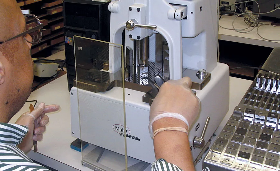

Calibration is a method or a process to determine if the item under test is meeting or not meeting its performance requirements. A gage block is a good example of this. It is brought into an environmentally controlled room and measured on a piece of equipment that compares it to traceable standards. Source: Mahr

Calibration is a method or a process to determine if the item under test is meeting or not meeting its performance requirements. A gage block is a good example of this. It is brought into an environmentally controlled room and measured on a piece of equipment that compares it to traceable standards. It is measured by a trained operator using a defined measuring process that has been established and had all potential errors relating to the process identified and their potential effect quantified. Once the gage block has been measured by this calibration process, it can be said to be within specification or not. If within specification, a calibration certificate is issued stating the block is within the specification defined and the actual measured value is shown. When a gage block is found to be out of spec, there is usually not much you can do to bring it into calibration specification; therefore it is commonly replaced or may be downgraded to a lower grade block where it would meet the calibration specs.
Many gages are more complicated than this simple gage block example. In these cases, the calibration process is performed and if the gage under test does not meet specification, then there is an opportunity to adjust the performance (or calibrate) the gage so that it does meet specification. This process will work whether the gage is a micrometer, dial indicator, bench amplifier/probe combination, or even a complex surface finish or form measuring system.
