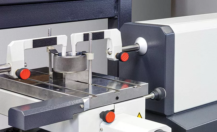

master ring gage being measured
Figure 1: A master ring gage being measured on a high-precision universal length measurement machine with a CNC measurement table.

ring measurement
Figure 6: A ring measurement on a universal length measurement machine with a CNC table. In the alignment tool within the software, one of two buttons actuate the CNC table move the ring: (left) tilt side-to-side, (middle) up and down (Z-Axis), and/or (right) front-to-back (Y-axis), as needed, in order to find the reversal point.

Second in prevalence to gage blocks is the class of ID and OD masters: master rings, master plugs, and master discs. These master gages are held to extremely tight tolerances and require multiple measurements, ID or OD, in order to obtain a certified measurement.
For many years, master rings and discs were certified on precision ID and OD comparators. These ID and OD comparators were highly-accurately measurement instruments but also labor-intensive. Due to the “comparator” configuration, they required a setting standard to first zero-out the comparator in preparations for the comparative measurement. These master rings and discs are typically manufactured to any specified size using certified gage blocks stacks as the reference point to create the desired diameter. Due to the required high-accuracy of these master gages, a second gage block stack is usually made to verify the first stack’s size.
Once the ID/OD comparator was set up, the user would take the subject ring or disc, place it on the gage between the contact points, and then usually tap the sample back and forth using a small plastic mallet. This would be done to find the min or the max value (i.e. the reversal point) as displayed on the analog dial readout in order to determine the correct reading once the part was properly aligned with the contacts. This process would then be repeated so that six measurements were taken for each part: three levels (top, middle, and bottom) each at 0 and at 90 degrees.
Universal length machines since have taken the place of many of these ID/OD comparators. They offer a longer direct measurement range and a high level of accuracy over that range. So rather than creating two stacks of blocks for every required size ring or disc to be measured, a single certified master ring or plug can now be used to set the system to a specific certified size and the ULM will be able to measure workpieces accurately within its direct measurement range.
While the visual aids are helpful in mitigating operator error in the measurement process, it is still a manual process. For the tightest of measurement tolerances, this level of error mitigation is not sufficient. Further removal of the operator’s influence on the measurement process must be now included, which is an important part of the construction of systems with axis control for measuring diameter.
Computer-integrated measuring systems feature a CNC table onto which the measurement artifact is mounted. Once the operator has placed the part on the table and properly affixed it, the system will automatically perform the required adjustments at the click of a button in the software until the reversal point is found. While the visual-aid-based process is available with CNC-controlled systems, the motorized table eliminates the operator influence from the reversal point search.
