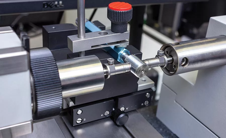

Figure 1:  Measurement of the major diameter on a thread plug

On a straight threaded plug gage, the two most common checks that need to be certified are the plug gage major diameter and the pitch diameter. As with other dimensional standards, there are industry standards that define how thread standards must be calibrated. In this case, ASME B1.3 is the one to reference.

The major diameter is checked by placing the test piece between the reference and sensitive jaw in the gage. In making the measurement, the specification calls out the number of measurements to be made on the threaded plug along with the proper gaging pressure to be used. The gaging pressure is typically the same as is specified when making the second most common check on the threaded plug, the pitch diameter. Ensure the same gaging pressure when making the OD check.
