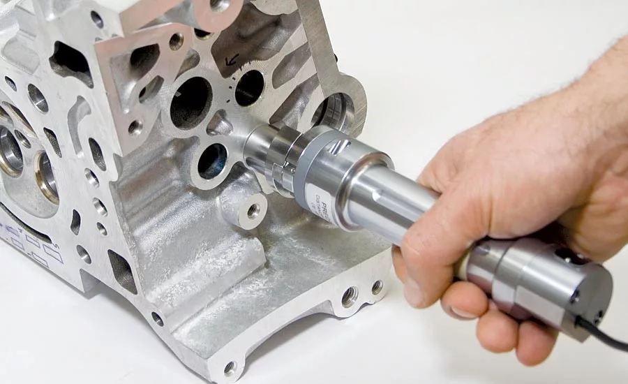

Is the surface to be checked for finish so difficult that even a very skilled operator would be unable to make accurate and repeatable measurements using standard portable gages and fixtures? If so, a custom dedicated probe holding and alignment system can drastically speed the process, improve the measurement, and likely save on broken probe replacements. Source: Mahr

Part feature, dimension and tolerance to be inspected. Is it flat, round or otherwise? ID or OD? Is it a static or dynamic check? Where is it and is it easily accessible, or is it next to a shoulder, inside a bore or a narrow groove? Is it critical or just nice to have?
Workpiece material and finish. Is the part compressible? Is it easily scratched? Many standard gages can be customized to avoid such influences. Or proper contacts can be chosen to reduce scratching or picking up material.

If the part is simply an OD with a generous tolerance, then a caliper, micrometer, or even a dedicated snap gage would be potential solutions. However, if your key factors include performance (accuracy and repeatability), time and throughput, ease of use and operator skill, assured part classification, and cost per piece, then a custom gage solution is one that should be considered.
Often custom gaging is thought of when a solution is needed for a high precision, tight tolerance part. But things can get complicated: there may be more checks; they may not be ODs or IDs; the process being checked might be automated and a gage user may not exist. You may even have a fairly wide tolerance but the feature being checked is so difficult that any user—even the most skilled—would be unable to make accurate and repeatable measurements. Along with the gage, you need to consider part staging.
