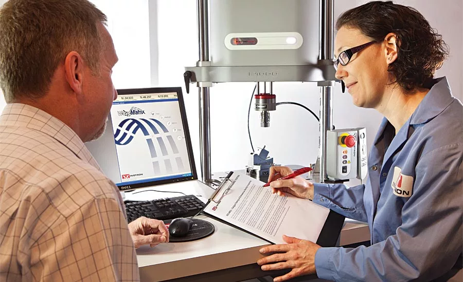

IQ/OQ documentation
IQ/OQ documentation is one of the most important facets of 21 CFR Part 820.
