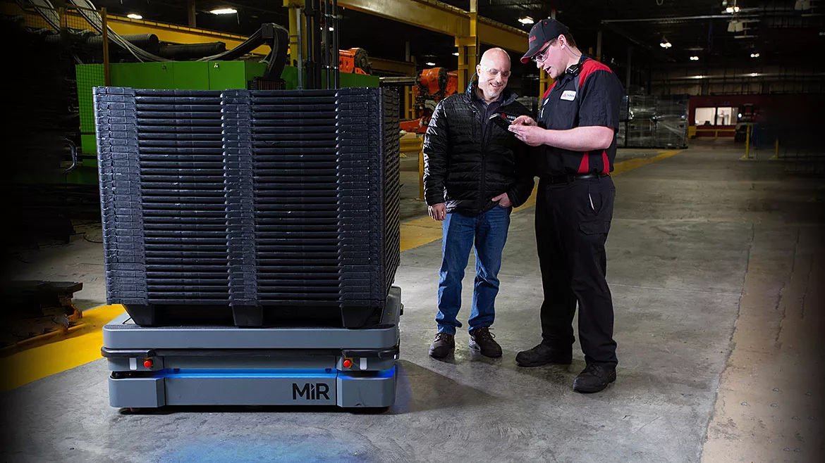

What about standards for mobile robots? And what steps are needed to ensure a safe deployment for these types of robots?
In late 2020, A3 published Part 1 of the R15.08 ANSI standard to establish safety requirements for industrial mobile robots (IMRs) as guidance for robot manufacturers. Part 2 of the R15.08, which has just been approved, establishes safety requirements for deploying IMR systems into an industrial environment, including integrating, configuring and customizing the IMR or fleet of IMRs into a site.
Safety guidance for IMRs continues to evolve along with new technologies and use cases. The most important step is to consider the entire mapped environment – a different mindset than a fixed robot cell or an automated guided vehicle (AGV). The integrator must assess the entire facility where the IMRs will operate and manage the deployed operating environment (DOE). Because the IMR system could be deployed in an existing facility, the DOE might not match the specified operating environment (SOE) provided by the IMR manufacturer, so could require plans for mitigating hazards arising from the mismatch. The layout analysis must intentionally design interactions between IMRs and workers as well as between IMRs and docking or charging stations.
As with the R15.06/10218 standards, risk assessment remains a critical element for safe deployment of mobile robots, particularly when they are not constrained to a defined path. Standards provide important guidance on requirements such as protective and emergency stops, collision avoidance, speed control and stopping distance, as well as cybersecurity concerns.
