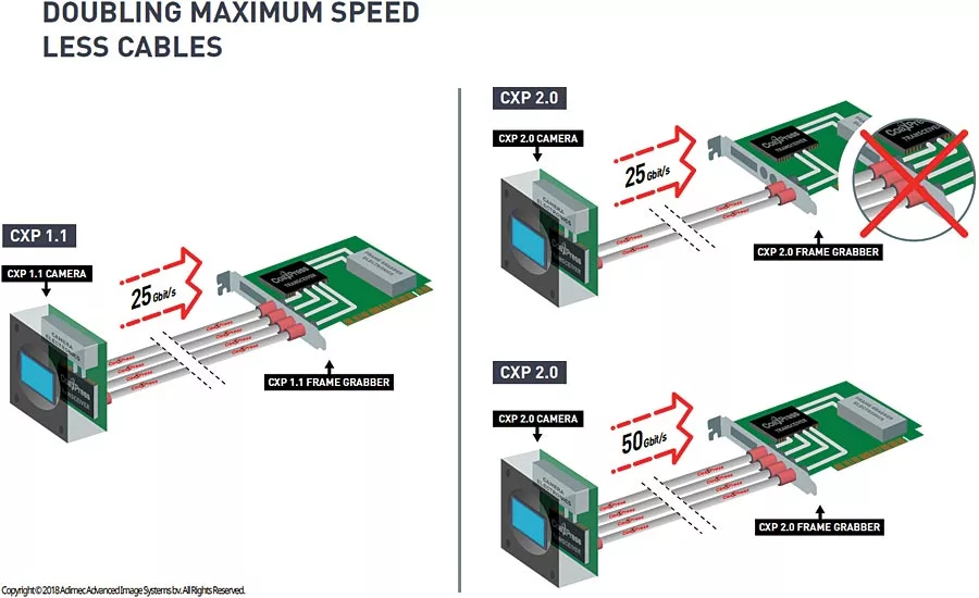

CoaXPress 1.1
Figure 1: The most important difference between CoaXPress 1.1 and 2.0 is the increased data rate per cable. This will allow for a larger frame rate or the use of less cables.

To fulfill these requirements, the optical inspection and metrology equipment need faster motion to bring the device under test to the measurement point, faster and more complex algorithms to analyze the defects, and more accurate and faster electro-optical vision modules. In these EO-modules cameras with a throughput of 5 Gigapixels per second are needed to support the required resolutions and frame rate combination. This asks for an interface which goes beyond existing available standards. With CoaXPress 1.1 (CXP1.1) using four channels, data rates up to 2.5 Gigapixels per second can be achieved. The new CoaXPress 2.0 (CXP2.0) standard supports up to 12.5 Gbit/s per coax channel, which allows an affordable design of cameras that can run up to 5 Gigapixels per second with four CXP channels; one channel represents one cable.
CXP2.0 with four channels at CXP12 allows you achieve 5 Gigapixels per second data throughput. With CXP1.1 this is also possible, but requires doubling the number of channels on both the camera and frame grabber to eight each. In this case especially, the camera will increase in size and more cables are required, making the system design more complex and expensive. In terms of power and thermal management four CXP2.0 channels at CXP12 is likely to win as well. When you need 5 Gigapixels or more, going to CXP2.0 is the most logical step.

2.  Doubling of the maximum speed
The most obvious improvement is the increased data rate. As previously mentioned the CXP2.0 can reach up to 12.5 Gbit/s. This 12.5 Gbit/s mode is referred to as CXP12. Due to overhead the actual effective bandwidth is approximately 9.6 Gbit/s.
Just to give an example of what would become possible, let’s consider a sensor resolution of 5120x5120 and a bit depth of 10 bit. With four CXP2.0 channels at CXP12 the theoretically possible frame rate could be about 146 FPS. CXP1.1 with 4 channels at CXP6 would only achieve up to 73 FPS in this case.
One thing that needs attention from a system engineer’s point of view would be that while for CXP1.1 PCIe gen2 x8 or gen3 x4 is sufficient for most cases, for CXP2.0 PCIe gen3 x8 will become a minimum common requirement.
