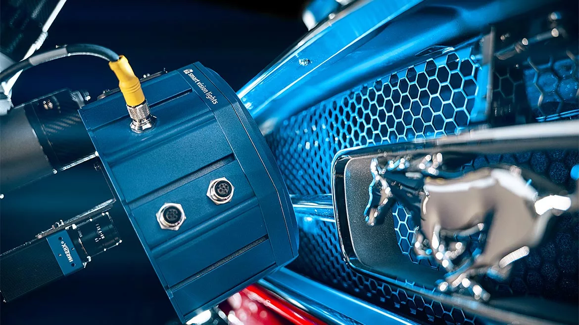

Figure 1: Pairing a machine vision camera with a multifunctional lighting unit at the end of a robot arm enables flexible inspection of various automotive part types. All images source: Smart Vision Lights

While static illumination designs suit many of today’s automation systems, dynamic configurations offer significant flexibility when it comes to dealing with part and process variations. A dynamic lighting solution also offers variable geometry, which allows for the use of more than one type of lighting geometry in an integrated, compact unit. Dynamic lighting also offers the ability to change the illumination wavelength or intensity quickly for short production runs of widely varying parts, oftentimes on parts of the plant floor where size and space constraints present challenges (Figure 1).
Take the industry in which automation is most prevalent – automotive manufacturing – for example. During body assembly, adhesive beads are applied during multiple steps, including joining inner and outer panels and applying noise suppression or sealant materials to panels. These beads must be inspected for width and volume as well as the presence of skips, bubbles, or voids. Systems integrators often affix a camera to the end of a collaborative robot (or traditional robot) arm to perform these different inspections, but doing so requires lighting that can accommodate different inspections, which may include presence/absence, defect detection, color matching, color identification, alignment, and more.
When performing multiple tasks such as these, the ideal lighting can vary by inspection type, which may have traditionally meant changing out the lighting for each step, which adds time and costs to the scenario. Novel lighting designs, however, have removed the need for additional lights for individual inspections. Multifunctional lighting units – which include dome light, low-angle dark field ring light, mid-angle dark field ring light, RGBW ring light, four-quadrant ring light, NIR ring light, and sequencing controller – enable advanced control capabilities for disparate inspection tasks, without having to change the light (Figure 2).
