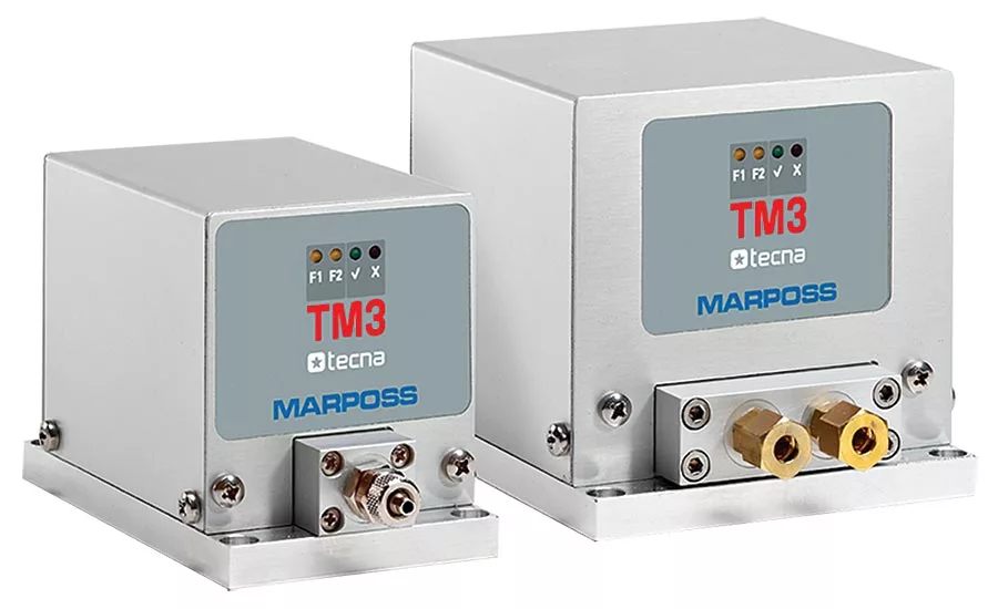

Pressure decay leak testing is similar to bubble emission in that it also includes the core routine of sealing the part and pressurizing it with a compressed gas—normally air. However, instead of an operator looking for leakage location (bubbles), the technician monitors change on a pressure gage after isolating the test part from the air supply.
A leak test instrument can also be utilized in this approach, helping to remove potential operator bias from the test. A basic pressure decay leak test includes a test pressure regulator, solenoid valve, absolute pressure transducer and leak test instrument, which makes the pass/fail decision.
Differential pressure decay utilizes the same core routine and pneumatics, but adds an isolation valve and differential pressure transducer so that a test part and a reference part can be pressurized in parallel. When isolated from the pressure supply, the absolute pressure sensor verifies the correct test pressure and the differential pressure sensor monitors the change between the two cavities allowing for a more sensitive test.
Pressure decay can also be converted to a flow rate, sometimes called a predictive test. This will produce linear, repeatable and reproducible results.

Mass Flow – Leak
Mass flow is similar to pressure decay testing, but it adds a mass flow sensor. A simple mass flow pneumatic setup includes a pressure regulator, absolute pressure transducer, mass flow sensor and isolation valve. The part is pressurized, and the absolute sensor ensures the required test pressure is met. In this approach, the test part is not isolated from the air source, so the mass flow sensor measures the amount of air required to make up for any leakage out of the part.
