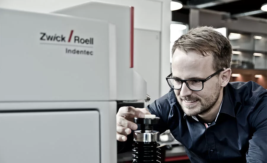

Rockwell hardness testing
Rockwell hardness testing offers an attractive alternative to uniaxial testing in some metals applications where sample geometry would make test preparations overly cumbersome. Operators simply place the sample on the mounting rig and engage the touchscreen to begin testing.
