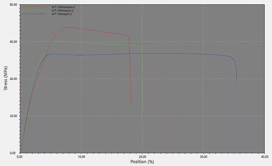

Biologics, plastics, synthetic fibers and metals at elevated temperatures are examples of viscoelastic materials. Viscoelastic materials are time dependent which also makes them strain rate sensitive. Figure 4 includes the stress-strain response of a polypropylene strip loaded in tension at strain rates of 20%/min, 200%/min and 2000%/min, respectively. The figure shows that the faster the strain rate, the higher the maximum stress and the lower the elongation at failure. For those comparing the relative strength between batches of like viscoelastic materials, Figure 4 illustrates the importance of testing each sample at identical strain rates.

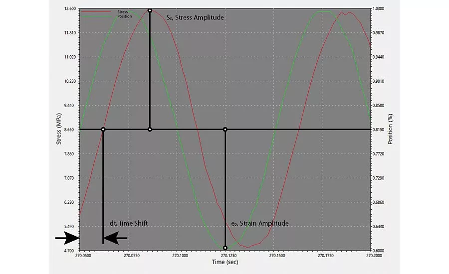

Dynamic mechanical analysis is performed by applying an oscillating stress at varying frequencies to a sample and analyzing the strain response to the applied stress. Figure 5 depicts the applied sinusoidal stress waveform and the responding strain waveform of a polypropylene sample loaded in tension only. The time lag or phase shift of the strain response is used to quantify its viscous behavior; the slope of the stress-strain response relates to its elastic behavior. These properties are often described as the ability to lose energy as heat (damping) and the ability to recover from deformation (elasticity).
A sample subjected to a sinusoidal stress amplitude controlled waveform will deform sinusoidally as shown in Figure 5. The response will be reproducible if the material remains within its linear viscoelastic region. At any given time, the applied stress, S(t) is given by:

To summarize dynamic mechanical analysis, a sample is subjected to a sinusoidally varying stress of amplitude, So, and frequency, f, or period, T (1/f), and the amplitude, eo, and time shift, dt, of the resulting strain waveform is measured. From this, the phase lag or loss angle, θ, is calculated from Eq. 4 and the elastic or storage modulus, Eʹ, is given by:
equation9
The amount of energy lost due to friction and internal motions, called the loss modulus, E˝, is given by:
equation10
The tangent of the phase lag or loss angle, tan(θ), is called the loss tangent or damping factor and provides a measure of how much energy is lost due to the viscous nature of the material. From Figure 5, we can determine the following viscoelastic properties of the polypropylene sample.
dt = 0.012 sec
T = 0.1 sec (10 Hz)
So = (12.521 – 4.779)/2 = 3.871 Mpa
eo = (1.0244-0.6049)/(2 x 100) = 0.00209 mm/mm
Using Eqs 4, 9 and 10, the loss angle, storage modulus and loss modulus are calculated as:
q = 0.012/0.1 x 360 = 43.2 deg
Eʹ = 3.871/0.00209 x cos (43.2) = 1,350 Mpa
E˝ = 3.871/0.00209 x sin (43.2) = 1,268 MPa
In addition, the loss tangent, tan(θ) = tan(43.2) = 0.939.

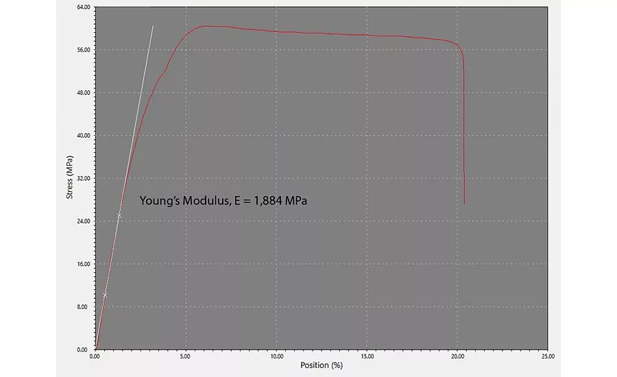

ASTM D638 Standard Test Method for Tensile Properties of Plastics governs the determination of Young’s Modulus for polypropylene. Figure 6 is the stress-strain diagram of the polypropylene sample pulled in tension to failure. From Figure 6, Young’s Modulus of Elasticity is calculated to be:
E = 1,884 MPa
In theory the storage modulus, E’ and Young’s Modulus, E, should be equal. However, Young’s Modulus is calculated by continuously pulling a sample to failure and using a range of stress and strain values in the elastic region, whereas the storage modulus is calculated with a pair of stress-strain values at a given point in the elastic region under oscillating loads.
