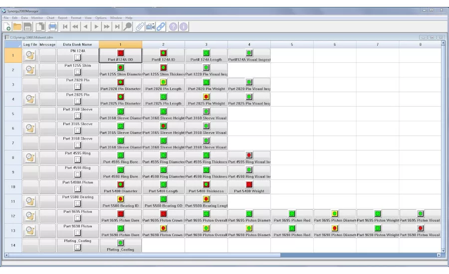

Zontec Synergy 2000 manager dashboard provides SPC visibility to every process on the factory floor with just a glance.  Source: Zontec, Inc.

One-click navigation and color-coding in the system top the list of ease of use. Whether automated or manually entered, data is instantly displayed in charts and reports that can be navigated with a click of the mouse, as well as notifications to any-and-all involved in the process, providing instant feedback, helping to solve problems and allowing for repeatability and reliability of the process.
“With the help of Zontec we got it all hooked up and everything is working as advertised,” said Roberts. And “as advertised” means the company’s quality personnel and operators are saving time and are guaranteed that all pertinent data is getting collected from manual entry to the connected gages, a coordinate measuring machine (CMM), or vision system. The system then prepares reports to be provided directly to customers.
Synergy 2000 reports can include performance metrics, profitability analysis, as well as Automated Certificate of Analysis, which shows that customer requirements and specs have been met. The reports are comprehensive and provide real-time data pulled from every aspect of the manufacturing process, gathering valuable intelligence about past performance as well as predicting future results.
