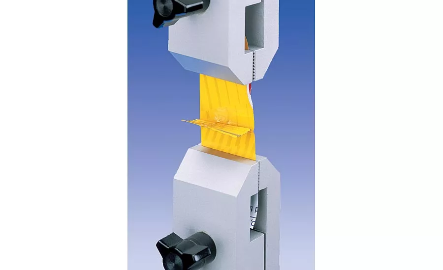

An example of peel testing with manual grips

The term tensile testing can be used broadly to include applications such as wire pull testing, peel tests for film/paper packaging, and the testing of plastic or rubber “dog bones,” or “dumbbells.” An example of wire pull testing is the use of fine wires, such as those utilized in the microelectronics industry. These are often used for connecting integrated circuits and printed circuit boards. To ensure proper functioning and reliability, the tensile strength of these wires must be tested. Another example of a tension testing is related to the quality of packaging material. Peel tests of food packaging seals need to be tested to determine if the package meets industry standards—easy enough for a consumer to open, but strong enough to withstand transportation. Lastly, rubber and plastic samples often require tensile testing. They are often cut into the

Wedge grips and parallel jaw grips can be fitted with various jaw surfaces. If the wrong jaw surface is used, samples may slip from the grips even if the capacity of the grip meets the test requirements. Plain jaws are blank with no coating and can be used with samples that could get damaged with coated jaws. Serrated jaws are recommended for metals and plastics. Diamond coated jaws can be used for paper and board samples, while interlocking wave jaws are often used for fabric. Rubber faced jaws provided the needed friction to secure glossy or slippery materials.
Wire, rope, yarn and tubing require specialized grips to secure each specimen. Wire turret grips are available for wires with terminal or connector ends. These grips have an indexing wheel that contains grooves of varying widths to accommodate a wide range of sample shapes and sizes. For wire or cable without terminals, a bollard-style grip can be used. The wire can be wound around the bollard and through a small vise to secure it. Medical sutures are similar to wire and can also be tested this way.
Specialized grips for film or paper can have interlocking jaws to secure the material. The jaws allow the material to be held without tearing it prematurely. And, last but not least, a pair of hooks, while simple in design, might be the best option.
