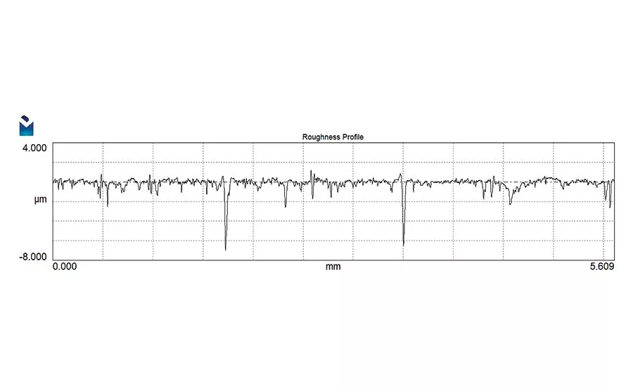

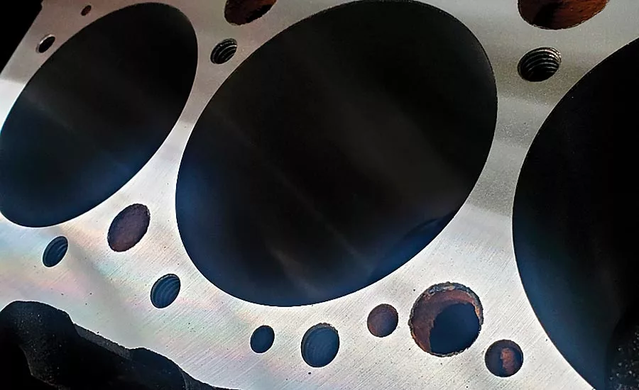

While roughness measurement clearly is important, it cannot prevent problems that lurk outside the roughness wavelength regime. As an example: an engine manufacturer found that a particular component was prone to leaking. A sampling of the parts was measured with a stylus profiler, and the profiler data was filtered to show the roughness (Figure 3). The average roughness met specification in all of the parts. So what was the problem?

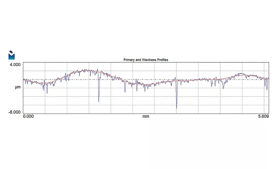

When the data was filtered to show longer wavelengths (Figure 4), several parts exhibited waviness variation heights of several microns over distances of several millimeters. This waviness was determined to be the source of the leakage, and specifications were added to control the waviness as well as the roughness.

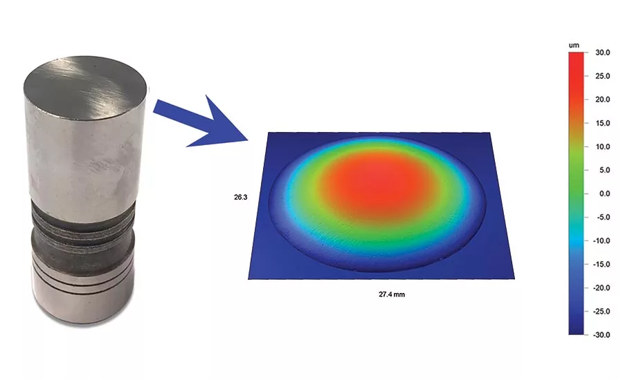

As a second example: an engine lifter is designed to follow the lobe of a cam in order to open and close the engine valves. Typically, the lifter is ground with a spherical crown shape to decrease contact stress (Figure 5).
A manufacturer found that a subset of lifters was causing significant engine noise. As in the earlier example, the roughness on a sample of lifters was measured, and all parts were found to be within tolerance.

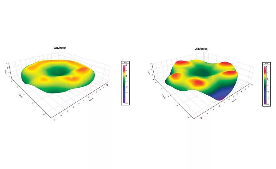

When the data was filtered to show the waviness, however, two distinct groups of parts emerged. The surfaces of those that performed quietly appeared flat after filtering was applied (Figure 6, left). Those that were noisy exhibited “lobing,” or periodic waviness around the lifter surface (Figure 6, right).
In diagnosing the problem, engineers determined that a grinding process was imparting a very subtle degree of lobing around the lifter head that was not obvious in the general shape measurement. The lobing was revealed when the 3D texture data was filtered to remove the spherical shape and the underlaying fine texture. This level of surface texture analysis gave engineers the data they needed to eliminate the noise source.
