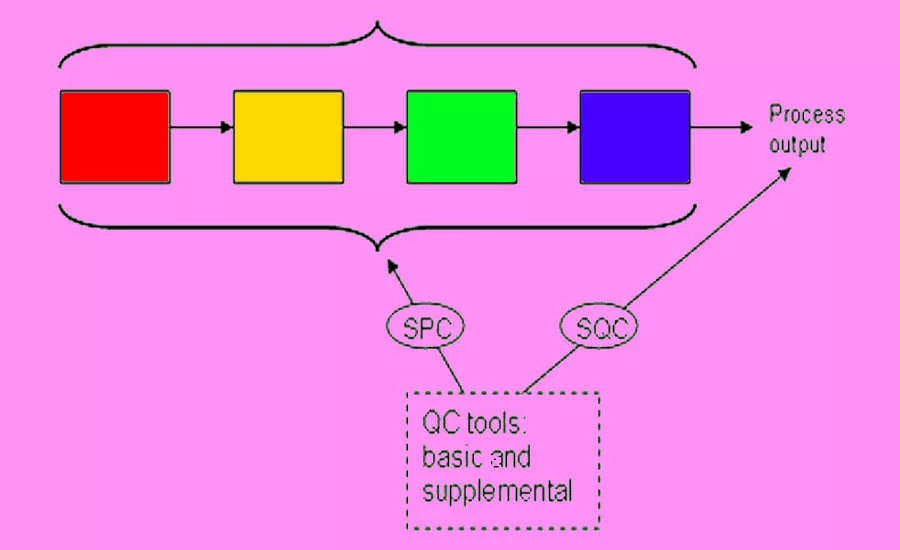

The American Society for Quality (ASQ), along with many other organizations, define statistical process control (SPC) as the use of statistical techniques to control a process or production method. These organizations further define SPC tools and procedures that can help monitor process behavior, discover issues in internal systems, and find solutions for production issues.
Often synonymous with statistical quality control (SQC)—the only difference noted is SQC’s inclusion of acceptance sampling—both have fourteen statistical and analytical resources or tools to control the manufacturing process. SQC attempts to control the outputs of the process, while SPC attempts to control the inputs.
Of the fourteen, seven are considered supplemental, or 7-SUPP, tools. The other seven are foundational quality-control tools, or 7-QC, and were first put together by Dr. Kaoru Ishikawa in 1974.
