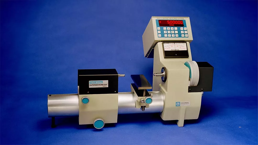

Supermicrometer
The Supermicrometer can measure just about any manufactured precision OD part, turned part, or gages such as pins, plugs, and threads. Image Source: Pratt and Whitney Measurement Systems Inc.

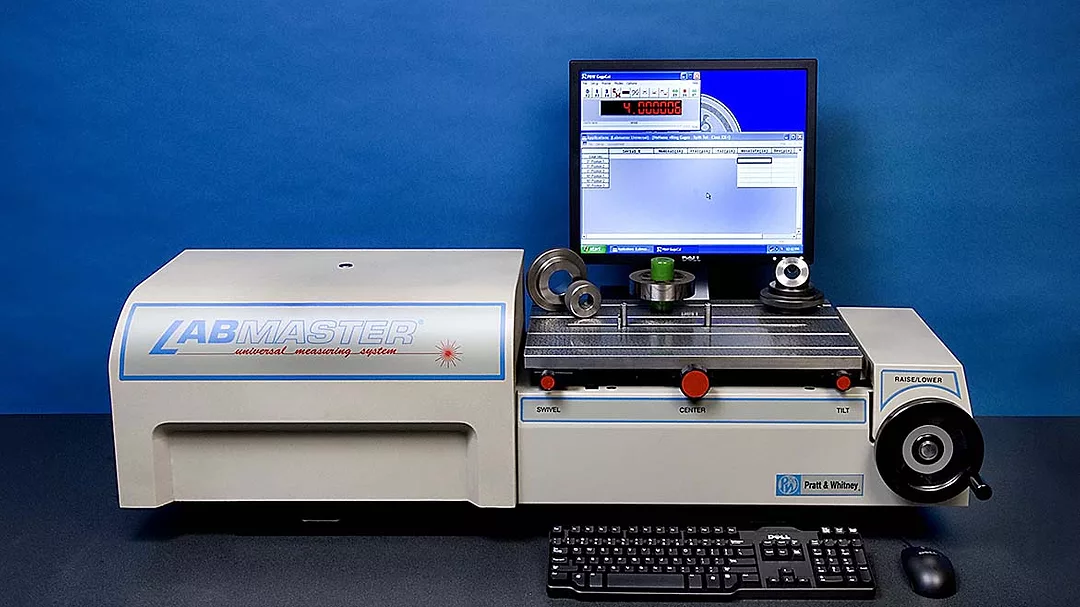

Laser-based universal length measuring machine (ULM), LabMaster Universal model 175
This laser-based universal length measuring machine (ULM), LabMaster Universal model 175, has been developed for gage calibration laboratories that need to precisely measure length, outside diameter, inside diameter, pitch diameter, lead, major/minor diameter, taper, linear displacement, and thickness.
