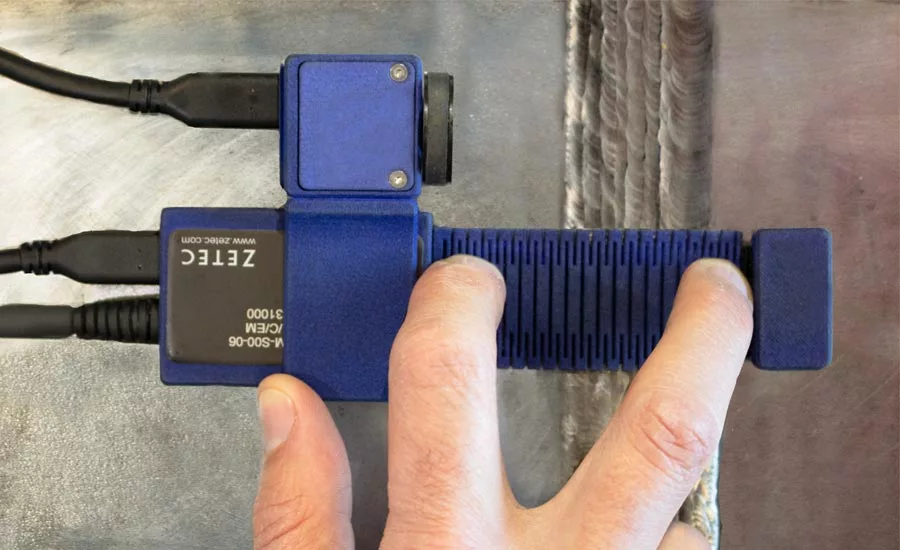

The C-Scan capability of the latest handheld ECA tools provides instant visual feedback to the technician. Source: Zetec
ECA advantages
Eddy current array (ECA) is an effective technique for detecting surface and subsurface indications in ferrous and non-ferrous materials, including cracks, pits, corrosion, and damage due to impact or fatigue, and requires no surface preparation or handling of chemicals. The newest generation of portable eddy current tools has dramatically increased test speed, accuracy, and repeatability, especially on long weld runs and large inspection areas. These handheld instruments have the processing power, software, and battery life to perform inspections virtually anywhere. Their C-Scan capability provides instant visual feedback to the technician, and they produce digital records of inspection that can be stored, analyzed, and compared against a history of results.
One practical limitation of ECA technology is that as the operator moves the probe across the surface under test, the excitation coils need to be close to the material for accurate flaw detection and signal quality. A flexible probe can conform and adapt to different surfaces and contours while keeping the excitation coils and sensing devices closely and properly aligned as the technician slides it over the surface.
