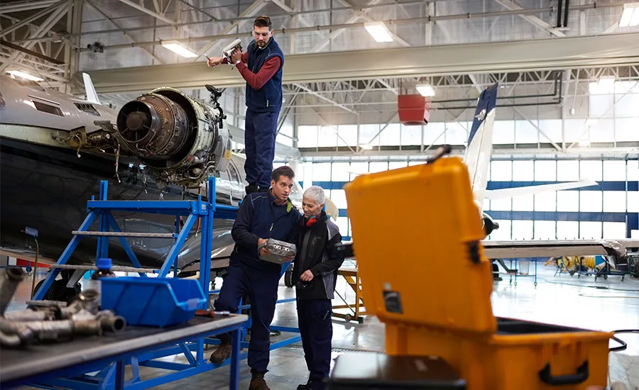

Typically phased array UT inspections take place in environments where an automated scanner can be used to precisely control the alignment between the probe and the surface of the material, and where technicians have the space, time, and powerful UT tools and software to inspect large components and complex geometries. However, the latest generation of phased array UT tools are portable, rugged, incorporate color touchscreen displays, and have powerful software onboard.

One of the challenges for NDT technicians in aviation is that efficiency is crucial and inspection points can be difficult to reach. There’s a need for tools that have faster data acquisition speeds and can conduct dual-frequency testing, digital conductivity testing, nonconductive coating thickness measurements, and other advanced techniques—yet are physically easier to handle. Instruments today are evolving in several ways:
Ergonomics: A focus on ergonomics has produced eddy current tools that are lighter and less fatiguing to use in tight, awkward spaces. One test of ergonomics and portability is how easy it is to operate the tool with one hand—with a glove on.
Display: A handheld tool with a C-scan display can present a digital “big picture” and help inspectors find more defects in less time. A display should be large enough to handle a range of modes—for example, two signals side by side, or a reference signal and a live test signal simultaneously. A touch screen can provide additional functionality and convenience.
