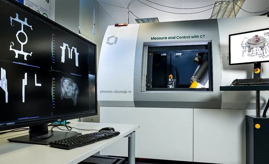

QTY August 2021 Industrial CT: Set-up of a CT systemSet-up of a CT system for dimensional precision measurement. All images copyright ‘Waygate Technologies’ (Click on image to enlarge.)
Recent Developments Of Advanced CT Systems For Metrology
Technological improvements especially in the most advanced industrial CT systems are now ensuring the consistent delivery of the required precision with fast scans and high sample throughput. For instance, a new powerful 300kV microfocus CT system for 3D metrology and defect analysis like the Phoenix V|tome|x combines a variety of proprietary CT innovations for reproducible precision measurements in a comparatively short time.
This kind of new technology allows to automatically remove scatter artifacts in just a few minutes and achieves a significantly higher image quality, especially with highly absorbent samples, which could otherwise only be achieved with significantly slower line tomography, taking about one hour or require the investment in more expensive 450kV high-energy CT equipment.
