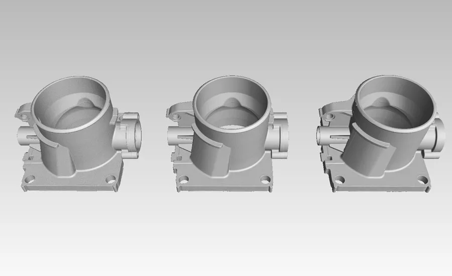

This is the same part scanned at three different speeds.
This is the same part scanned at three different speeds. They all appear the same until you have the software compare them. Source: Zeiss

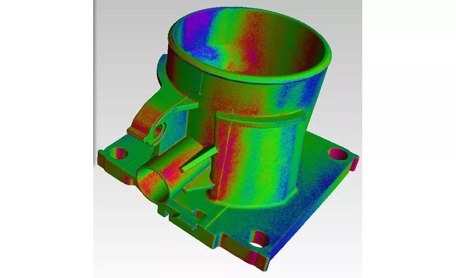

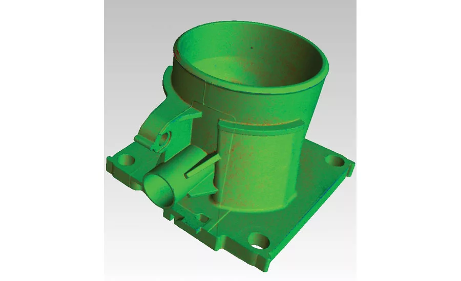

Color used to show dimensional variation to the baseline part.
Color used to show dimensional variation to the baseline part. Fig1: Part Scanned 30% faster than baseline. Fig2: Part Scanned 100% faster than baseline. Source: Zeiss

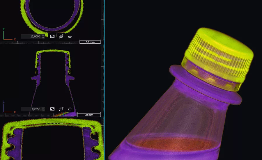

The software uses color to show different parts (densities) of the assembly.
The software uses color to show different parts (densities) of the assembly. Color transparency is added to accentuate details further. Source: Zeiss

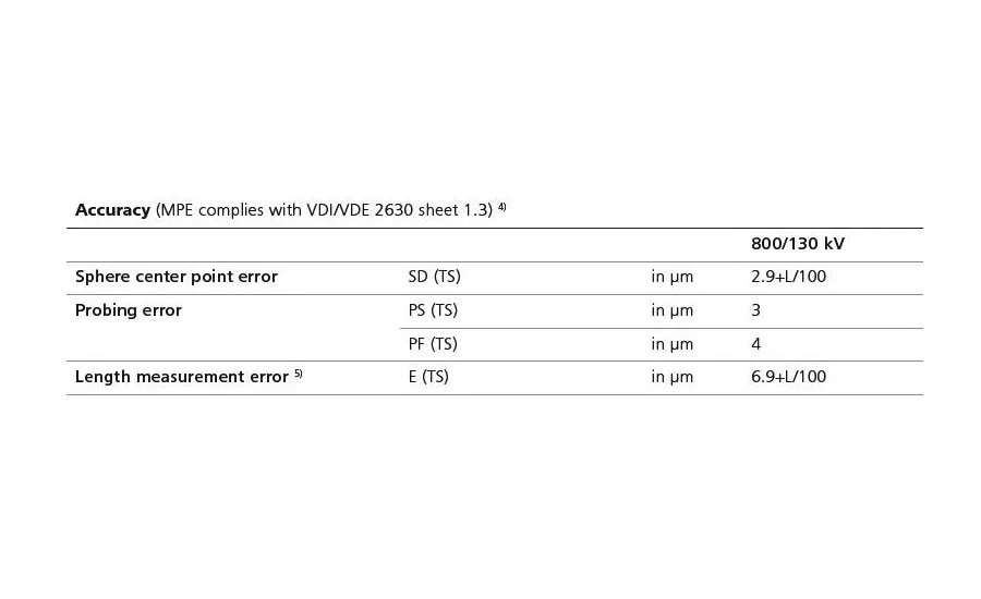

Look for these MPE (x) values on the spec sheet.

Would you buy a measuring instrument (caliper, height gage, CMM, etc.) if the manufacturer did not certify its accuracy?  As previously noted there are two distinct classes of CT scanners: Traditional CT scanners and CT-CMM scanners (Metrotomography systems).
  1. Traditional CT Scanners:  These are designed to nondestructively visualize internal defects of parts or assemblies. While the same data can also be used to generate measurement results like distance, angle, diameter, etc., the numbers aren’t to be trusted. Currently there is only one recognized specification for manufacturers to state their CT accuracy: VDI-VDE 2630 1.  Traditional CT Scanners do not state accuracy per VDI-VDE.
  2. CT-CMM Scanners: These are purposely designed to perform like a coordinate measuring machine. The best ones have a well-considered temperature management system including a kinematic design that resists unwanted structural stress and yields data repeatability. Their guideways and rotary axis performance is typically measured with a laser interferometer so that static and dynamic deviations can be corrected by the controller while scanning. As a final step in their production process, the accuracy performance of these systems must meet their VDI-VDE specifications.
Summary:  Most manufacturers offer both CT types. Each will produce stunningly photo realistic images but only VDI-VDE specified units should be trusted for dimensional reporting.

There are no free rides in the world of CT.  Like a car, the scanning speed (throughput) of any CT machine can be increased, but at what cost?  With a part in hand, inquire what the scan time would be to have a high degree of confidence in the results. Next, scan a part and use the results as your baseline.  If you plan to report dimensions (length, width, diameter, etc.) inquire if their system’s MPE(x) accuracy statements are guaranteed (qualified) at that speed.  With baseline data in hand you are better prepared to compare throughput tradeoffs like accuracy and image sharpness.

Mixed materials can be a challenge for CT machines. If you plan to measure parts or assemblies that use a mix of materials, ensure the software incorporates algorithms to accurately measure each, compensating for the difference in their relative densities. Other factors in evaluating CT/CMM software include ease of setup and programming and clarity of reporting and presentation of results.
