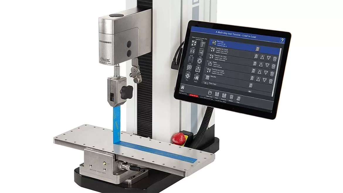

QM 0222 Quality 101 F305 G1103 Wire Pull Test
Adhesive properties can be measured by subjecting a tape sample to a 90° peel test. Source: Mark-10 (Click on the image to enlarge.)
Peel Resistance Tests
Take, for example, the ever-popular material tests that examine peel resistance. Intuition might suggest these tests would be quite simple: just peel something resembling a piece of tape at a fixed speed and capture the peak force that occurred while removing it from some surface. In this scenario, capturing the peak force that occurred during the peel would tell us how much force was required to break the seal at its very strongest point. But—come to think of it—do seals always fail because their very strongest point was not strong enough?
It turns out, evaluating the strength of a seal is actually not so simple. These tests typically aim to determine both the average force that occurred over a given length of peel and also the minimum force that occurred over that same length. Complicating matters further, test methods usually insist that the advanced force tester ignores the beginning and end of the peel to only consider some predefined segment in the middle:
