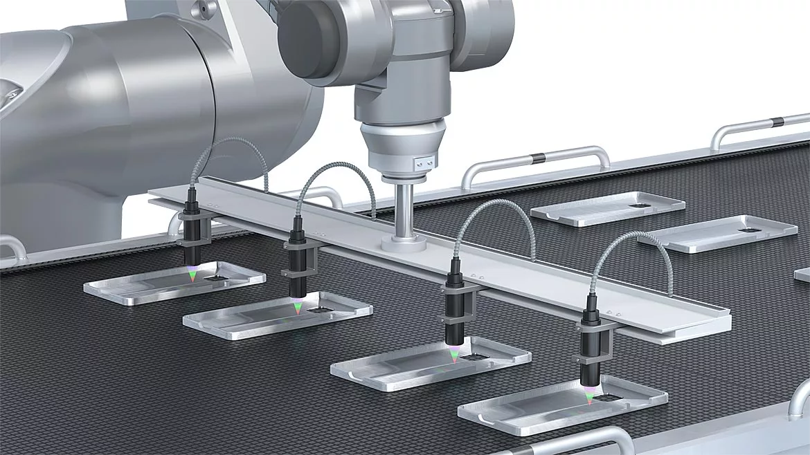

QM 0722 Measurement Confocal Sensors FT and 4 sensors 01
Whether rough or mirror-like, the system can handle a wide range of materials, including glass, stainless steel and ceramic. Source: Micro-Epsilon
