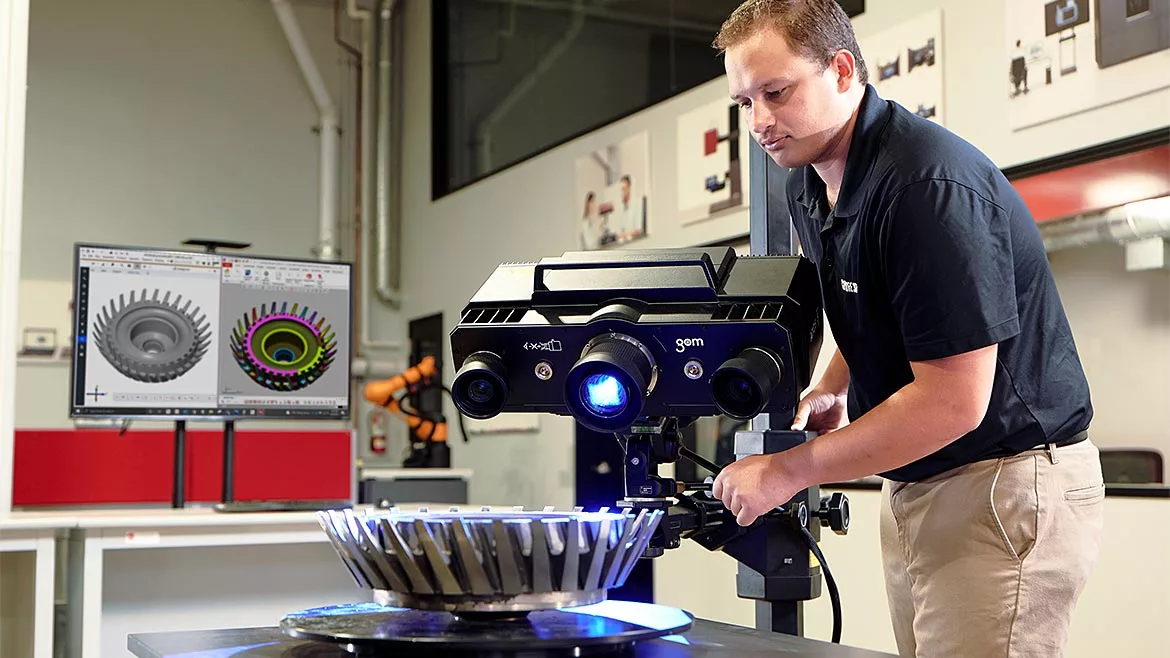

QM 0223 Quality 101 3D scanner in action with digital twin data

A digital twin is a digital replica of a physical asset, system, process or place that enables its remote monitoring and analysis throughout its lifecycle. In metrology, a digital twin is a geometric digital model of a physical part, tooling, or assembly derived from 3D scan data. When created using an accurate, high-resolution 3D scanner, digital twins enable the ability to make reliable decisions based on insightful data and perform comprehensive analysis to improve quality control, geometric dimensioning, planning efficiency and processes through simulation. In addition, the as-built digital twin provides statistical process control (SPC) analysis and trend insight to predict potentially problematic areas before they occur.

QM 0223 Quality 101 Automated blue light 3D scanner for digital twin creation
Structured blue light 3D scanners are the preferred method of creating high-resolution digital twins for quality control due to the technology’s accuracy and speed.
