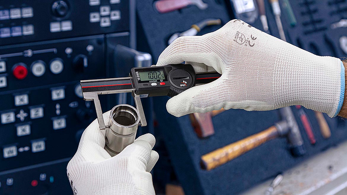

When measuring or exploring the wall thickness on cylindrical parts, the two flat surfaces of a standard caliper will cause measurement errors since one jaw will measure a chord rather than a line contact. To perform this measurement properly, one of the jaws must be cylindrical. This allows for a line measurement on both the ID and OD of the part for true wall thickness.

Measuring the outside or inside diameter or the width of a machined groove calls for yet another type of caliper contact blade. These grooves can sometimes be so narrow that neither a standard nor reduced face caliper will fit entirely into the groove. Pointed blade contacts, as the name implies, are very slender and flat. They nest readily into narrow-bottomed grooves. Other versions have a configuration that funnels down into a very narrow point for getting into deep groves. These narrow-tipped jaws fit into tiny grooves and tracks, making many previously difficult ID and OD measurements much easier. However, use caution as excessive pressure on these narrow blades—e.g., while the tool is being rocked to find the true diameter—can result in premature wear.
