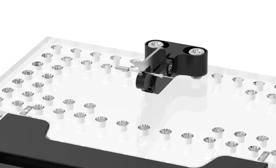

Phillips Precision unveiled the new Mini-Vise, the latest addition to their acclaimed Inspection Arsenal® system. Aptly named for its exceptional capabilities, is engineered to provide effective holding for very small parts. In fact, it may set a new standard as possibly the smallest clamp on the market today, showcasing Phillips Precision's dedication to innovation and pushing boundaries in metrology and manufacturing.
Key Features:
•    The Mini-Vise boasts an impressive range capacity, accommodating a work piece ranging from .010” to .250” in diameter, catering specifically to the needs of small parts in various industries.
•    The Vise features an adjustable spring-loaded mechanism, allowing users to fine-tune the holding force from 0 to approximately 3.1 lbs., ensuring secure and precise holding without part distortion or marring.
•    With a focus on adaptability, the Mini-Vise can be seamlessly set up either horizontally or vertically, on imperial and metric Loc-N-Load™ Fixture plates. This unprecedented flexibility in small work holding redefines the possibilities for precision measurement and inspection processes.
•    Crafted with precision and durability in mind, the Mini-Vise is constructed from black anodized 6061-T6 aluminum and 304 Stainless Steel, ensuring longevity and reliability.
•    The Mini-Vise's retaining crown is impressively slim, measuring just .190" in width, making it an ideal solution for applications where a clear line of sight or space for a touch probe is elusive, yet critical.
