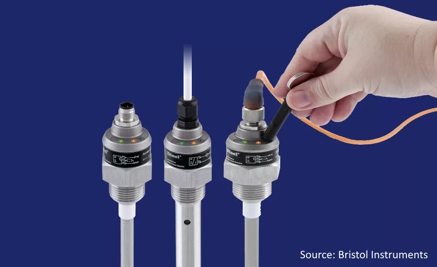

Bristol Instruments introduces the Dinel DLS-35 Series of capacitive level sensors. These sensors are designed for use with liquids and bulk solids. Limits are set easily with a magnetic pen. A quick-set mode lets users perform set up without the presence of medium.
DLS-35 level sensors can be directly mounted to tanks, vessels, sumps, tubes, silos and hoppers. Bar, rod and rope electrode options collectively cover electrode lengths from 2 in (50 mm) to 19.7 ft (6 m) over five range options.
Two LED indicators show operation status and provide visual confirmation of settings. Signal output options are NPN, PNP or NAMUR (change in supply current).
DLS-35 Series models for operation in standard, high temperature, mining and explosive environments are available. Housing and electrodes are available in either 304 or 316L stainless steel. G3/4, G1, M27 and M30 threaded and C134 and C150 Tri-clamp process connections are available.
